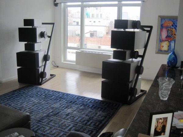

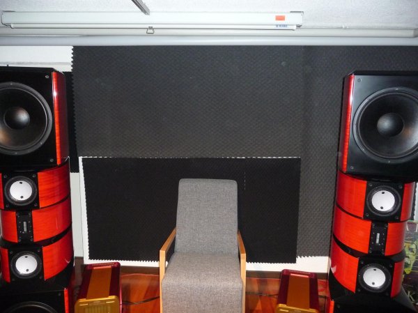

I guess I set the bar high with these 3 demo setups then:
