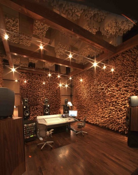

The diffusor pricing does not seem outrageous to me at all. I stumbled across this on pinterest a while ago, takes this concept to the extreme:
Reactions: infinitely baffled
They should do the floor too LOL.
Reactions: bonzo75
That photo is from Blackbird studios, studio C in Nashville. The designer of it is George Massenburg.
