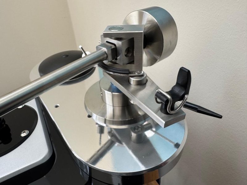

I am designing an arm board that attaches to the left rear tower on a TNT 6, similar to ones used on the Avenger (and HRX) turntables. Can someone who owns an Avenger check some measurements for me?
  • Overall width, length and thickness of the Avenger or outrigger HRX arm board;
  • Diameter of the circular opening of the arm board and diameter of the corner post;
  • Width and length of the gap in the “ring” of the arm board that narrows with tightening of the screw;
  • Size of the screw;
  • Final finish of the machined aluminum stock - painted, powder-coated or finely sand-blasted?
Would greatly appreciate any help you can provide and thank you in advance for your time.
Below is an early mock-up.

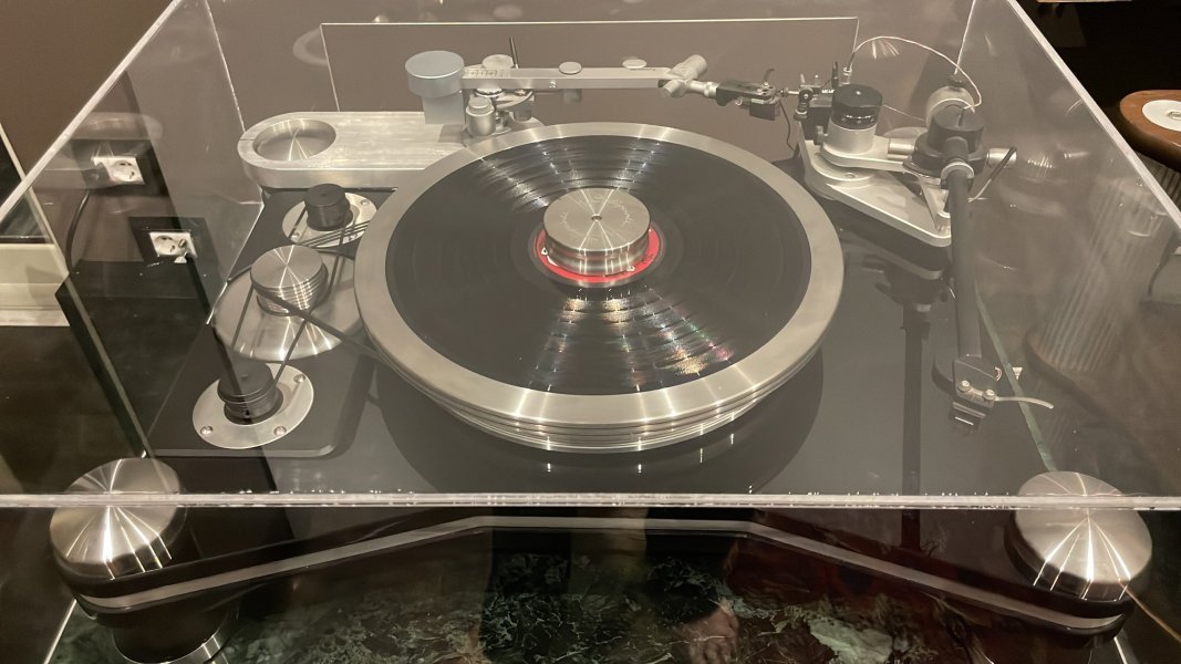

Here's the finished 2nd arm board mounted on a VPI TNT VI with a Glanz MH-1200S arm
Your work is beautiful, I wanted to take mine apart and have it polished to a mirror shineView attachment 146518
Thanks! I originally wanted a matte glass bead finish on the new arm board to match the VTA base. But the shiny, polished aluminum finish seemed a better match with the polished stainless steel on the Glanz arm.
