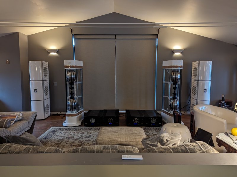

This is just the beginning of some of the work. I had a closet on the left side of the room that jutted into the room about 8ft and was around 9ft long. It was a box that caused the sound stage to shift to the left of the room. Accordingly I would need to place the speakers so they were shifted to the right to make the soundstage more naturally in the middle of the speakers. It was driving me crazy so I removed the walls (with approval of the woman in the house...she gains a window in the room and the room looks better). Now the speakers can be centered in the room with a natural center soundstage. Now I am going to start dealing with the slap echo in the room.
The next step is the removal of the hip wall behind the couch between the living room and the kitchen area. I am also contemplating dropping the elevated floor for better room flow....and also a sturdier foundation for the speakers and the system.
Still a work in progress. Patience is a virtue.PXL_20240323_134613301.jpgPXL_20240101_174934738.jpgPXL_20240325_143857721.jpgPXL_20240608_113631893.jpg

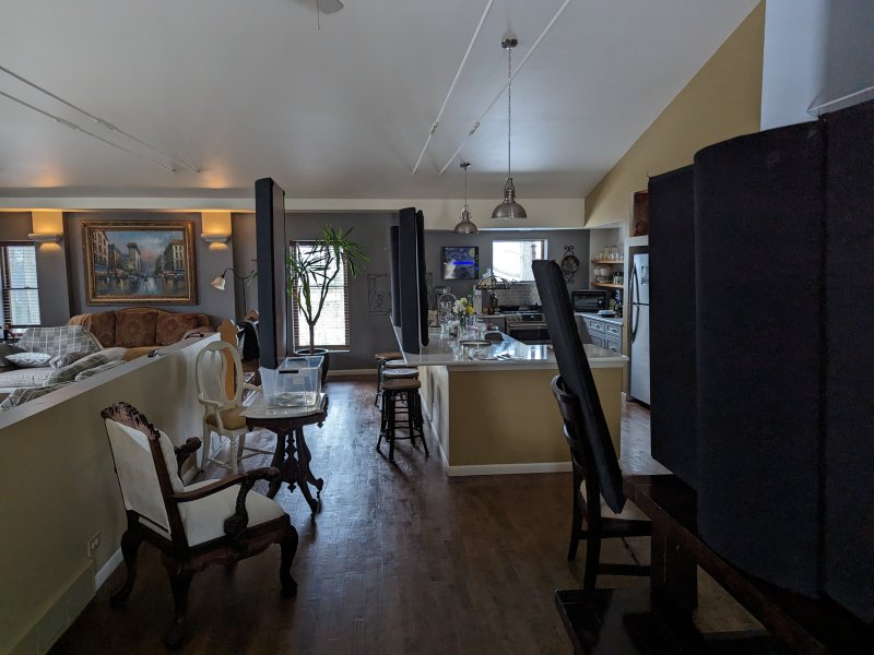

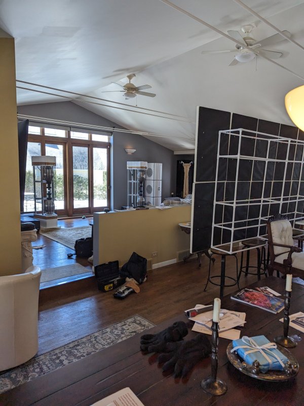

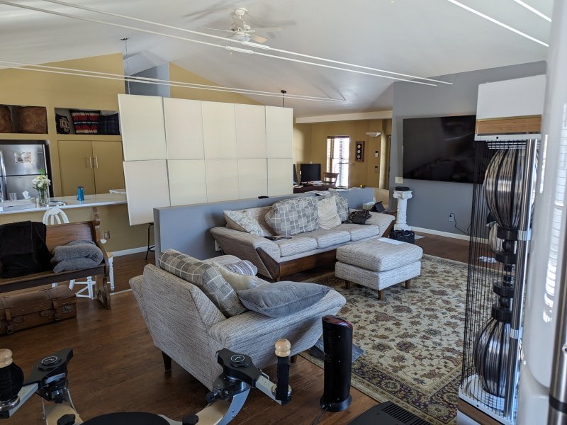

The pictures below are not permanent solutions but they give me a chance to hear what the listening space can sound like by greatly reducing/eliminating the slap echo effects coming from the back of the room. Ultimately I am going to try to tastefully treat the walls and ceiling and possibly floor. MBL's seem to like to have diffusion near the speakers and absorption in the back of the room. Bottom line is I know the room can get better because these experiments with a wall of absorption behind the listening space and in front of the back wall have given great results.
Next step is to start hanging absorbers from the ceiling.
Note that we tried the wall of white absorpers/treatments from Zanden in between the speakers. I did not like the results as it made the images sterile and two precise. Less alive and more like box speakers.
