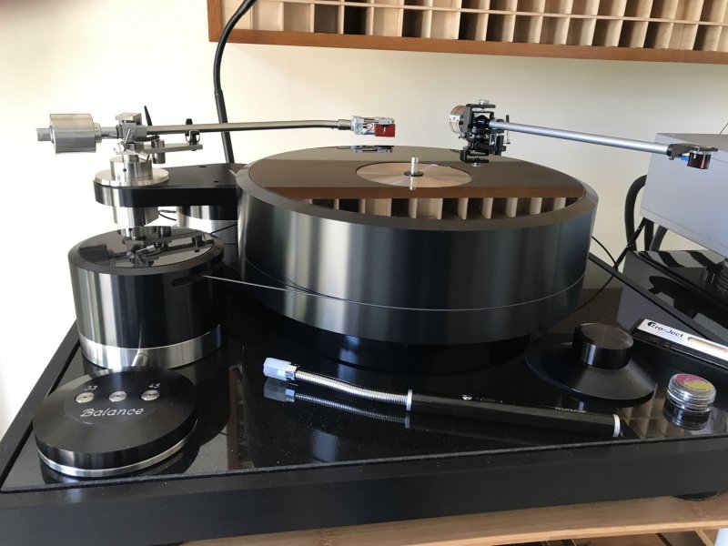

Finally took delivery of my Brinkmann Balance with Glanz MH-124S together with Brinkmann 12.1.
Glanz playing with my Koetsu vermillion is a revelation - tight full bass, airy open highs and the wonderful midrange....: with more resolution and lower surface noise.
still breaking in the Glanz (blue) cable - but already the combination - balance, Glanz, Koetsu so much better than my Avid/SME.
Fantastic looking setup .. congrats. I have been enjoying he exact same thing (except AS Aquilar arm in rear) for the last six months and can't say enough good about it. Running a Lyra Atlas Lambda SL in the 12.1 and Lyra Etna Lambda mono in the Aquilar.
Would really love to add that Glanz MH-124S for the the Koetsu stone body carts I have, maybe it will be a revelation with them too.
Enjoy
Enjoy
I’m hoping that the Glanz will work well with the Koetsu stone body as I’ve just ordered a Coralstone diamond to use with it
