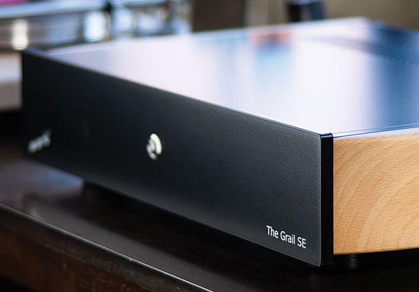

I was torn between the Boulder, the Nagra, and one I don’t hear a lot about the Van den Hul Grail SE+. The Boulder was too dear and, oddly enough, I liked the Grail more than the Nagra, probably because I tend to use VdH cartridges. Literally my only quibble with the Grail is it truly Radio Shack in how you have to adjust it. Pop the top off and flip switches. It’s an absurd lack of user friendly features for a $28k preamp. Mind you, I only did this once, but shouldn’t ever happen.

Why do you have to flip switches?
Level matching. To compensate the various level differences between all your audio sources, the Grail gives you the possibility to change the amplification factor. This amplification factor variation is also meaningful, if you use a quite “super-low”output voltage MC cartridge, or your high output voltage MC system is just at the “low side” of it's kind and you would like to use it at the MM input of “The Grail”.
It's simple, just four dip switches, but strange for a preamp that is otherwise plug-and-play. (As with all current-amplification MC phono preamplifiers, The Grail's circuitry automatically matches its impedance to an MC cartridge's input impedance, so there are no loading requirements.)
