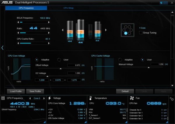

Overclocking Performed
I refer you to the exceptional video below on overlocking, for BIOS pictures of what needs to be tweaked and where, understand memory dividers, etc, so I will just mention the following overclocking performed on the system:
  1. CPU: BCLK=100MHz, CPU Strap=Auto, CPU Multiplier Ratio=44, CPU Cache Ratio=40; voltage settings kept at Auto (and ASUS managed them well). This gives me CPU speeds of 4.4GHz per core, and CPU Cache at 4.0GHz. At these speeds, operating voltages and temperatures are as described later on
  2. Memory: XMP 2400 Memory Profile (the other choice in my motherboard based on the memory I bought was 2666, but performance sagged)
  3. GPUs: +86MHz clock, +221MHz memory
CPU Speed & Voltages:

ASUS provides a nice Windows application called AISUITE3, which among other things, enables you to tune fan speed curves (as does the motherboard, but it’s easier using the app).
My goal was to keep the overall CPU temperature below 75C when stress tested, and any individual core’s below 85C – you will eventually find out that Intel’s CPUs throttle back if run too hot, starting at around 105C, with a hard shutdown at 120C; therefore, 85C is far away from the danger zone, ensuring long life.
The EVGA cards have a default operating limit of 80C which I didn’t touch, and in my stress tests, they reached as high as 81C. At these CPU temperature levels, CPU Voltage was as I wanted it, a hair shy of 1.3V, and CPU Cache Voltage at 1.25V.
The fan noise is extremely low, almost inaudible at idle and normal computer use, as only the CPU fans plus occasionally the rear case fan are running; and at full speed, with all 12 fans in the case blowing, the noise level is still acceptably low.

Hi, sorry I missed your question - I didn't have the bandwidth to stream 4K, but now I do and will try 4K videos... meantime, here's where it gets really fun now. The 2x970 FTW+ were a stepping stone until the new Pascal super-cards were to arrive in 2017. So they have now been replaced with a single EVGA GTX 1080Ti FTW3 Elite - with specs equal to or higher than the Kingpin - and a real unobtainium at this point. Part number is 11G-P4-6797-K1 (K2 in black) https://www.evga.com/products/product.aspx?pn=11G-P4-6797-K1 and this mother gives me 50% higher performance that the prior two 970s SLI'd, at effectively equal cost for either configuration!
Running the AIDA64 extreme stress-test, this computer now draws 600W of power
