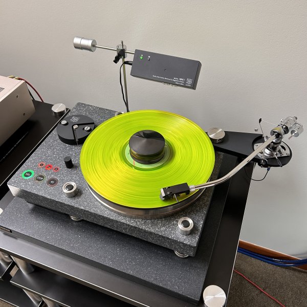

I assume you have to swing the active head device over the turntable after you have placed the record on the platter? So it does require physical manipulation every time you play a record, yes?
I read a review of this device which reported that it is clunky to also use the demagnetization function, as the active head device must be much closer to the record for demagnetization than it needs to be for de-staticing. Would you agree with this?

You don't need to swing it over. It stays in one place at the edge of the record so it's easy to place and remove records. It does not get in the way. Yes, technically for the demag you are supposed to lower it down which could be annoying. I don't use the demag. I also don't use the ground lug. One of my favorite audio purchases ever. Makes vinyl SO much more enjoyable especially in the cold dry months here.
no. the base sits on the plinth, and the counterbalanced arm holds the device which sits over a corner of the platter. the emitter is out of the way of disc handling completely. you press the green button at the beginning of a session, and turn it off at the end. using it is completely transparent to any record changing. maybe in some situations with multiple arms it might present an obstacle to work around. depending on plinth design. which is why my 2 tone arm NVS is using the DS Audio 001-ion instead. the IME1 does not fit with 2 tone arms. rather it fits but it's a bit too tight.
i ignore the demag function. not worth the bother to lower and raise. but it is an option.

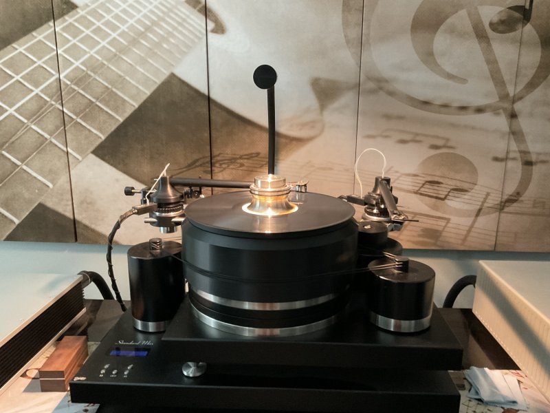

Do they make a special attachment for a tall table like this?

I think you'd have to put this one (as well as the DS Audio Ion 001) on some sort of platform or base.
there is no actual designated platform or base. it's all a matter of how tall your platter is above whatever surface you place the ion-001 on. the base of the Ion is basically 4" x 4". so maybe you need a 1", or 2", or 3" platform 4" x 4" to get the emitters above the platter by the designated distance. there are as many different sizes as there are plinths and rack surfaces.
i'm using the wood case for a Thorens record weight as my little platform. but it will be different in every case. i'd like a dark hardwood 2" x 4" x 4" block the same size so it blends with my Daiza platform and ion case and does not stick out. but have not found a source for that yet.

Thanks Mike. I have an excellent anti static device now (Furutech) but this looks much better. It eliminates static “continuously“, as opposed to once as my present device does. My platter is really high - 15.75” from the stand. So locating an 12” stand won’t be easy. I’ll write the company to see if they have an elevated base available. I’ll write J. Sikora as well. Thanks again.
