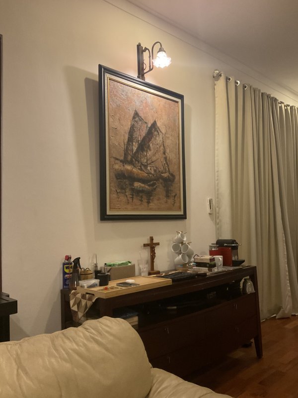

120 db is for when I have session with my wife or friends.It’s a good size room. Although I don’t see a point to crank up to 120db, I imaging you need a much more powerful amp. Maybe show us your room so we can find how you can treat your room.

Understand you will have more work to the room. I think it’s good size so no need to tear it down. You need some acoustic treatment on the ceiling and corners. Then at 120db I don’t think your amp has enough power to drive it, IMO. Very nice system though, enjoy.120 db is for when I have session with my wife or friends.
Front left to right
View attachment 85329View attachment 85330
View attachment 85331View attachment 85332View attachment 85333View attachment 85334 It’s still work in progress, nowhere near finished
