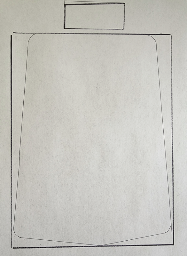

That's kind of exactly what I am thinking about doing. Making the room smaller (albeit slightly).
Hear me out. I know I don't want a rectangle. I have that now. What I would like to do (or what I am thinking about doing) is to (see photo below) Take the rectangle and build walls within it. My theory is to have nothing in the room that is parallel, including the ceiling and the floor. The corners would be bullnosed and what I mean by that is rounding them out over the course of two feet, not just a couple of inches.
The ceiling would be sloped, moving up as it gets further away from where the system would reside. The walls would move outward from where the system would reside. I was thinking about building in wall acoustical treatments, as well as ceiling treatments for the room as well.
In the diagram below, the dimensions are totally whack. I just wanted to do a quick sketch of my idea....or where my thought process is at this moment in time.
I will be going from the current room, which is 13x15x8 to an area (that also needs a powder room somewhere in the mix) I can work with that is 22x24'x12. I would need to subtract about 4 feet from one of the area dimensions for the powder room, physical music storage, the RCM and other storage for the system (possibly the rack as well). So, while I may be taking away, going from the current room to this would be a huge change for me and would allow the dual Rythmik F-25's and the Tyler Acoustic Woodmere's to have a chance to finally breathe.
I am still in the planning stage, so I am open to ideas. The build will most likely start in about 3 months or so.
Tom
Tom
Since I'm in process of figuring out the size and construction for my room, I'll tell you my thoughts and relative to yours: From what I've read, there are mixed results with parallel vs. non - parallel walls. As such, I have no plans to skew any wall(s). If I did anything non - parallel, it would be based on Art Noxon's premise that low frequency waves sometimes need to be coaxed directionally and away from your speakers. This not only aids in reducing all high / mid frequency smearing but also yields tighter, better bass (as he states). And in my case with side - firing woofers there is a reasonable probability that more low frequency energy is latent toward the front of the room vs. the mid / back. Now, this may matter less if my new room is ~30' deep vs. my current 19' but it's certainly worth exploring after the room completion (mock - up, measure adjust rinse, repeat).
Also, my concern with building non - parallel / skewed walls is - once it's done I'd be very reluctant to tear it down if the results are less than acceptable. However, I can build a wall - height wooden deflector to experiment and tune to best sonics at my heart's content afterwards. My 2 cents :)
Tom
Tom
In support of rectangular room I would propose thinking along these lines( obviously not knowing your constraints re entry etc)
You get max volume but use powder room and treatments to get the " fuzzy" dimensions as far as room modes go but you also get first reflection points directed away from listening chair .. 2 jobs done !... bass accumulates in corners so that is location for traps
As for ceiling baffles are the best .. you just locate them for stopping first reflections and have a flat ceiling ... cheaper and 20230216_114410.jpg
