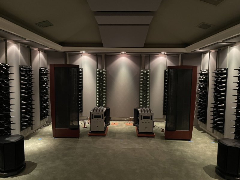

Custom dedicated audio room owners unite!
I work on quite a few projects and I also have my own diffuser product which can be seen on the back walls and doors of the demo room I have been building.
My interest lies with small listening spaces and let me tell you, it is not a popular one. Besides the ones who are working on various scientific experiments, most acousticians deal with noise or voice intelligibility. A very limited number of them work with concert halls and Some work for recording studio designs. Studio design has two faces (recording and mixing) and two separate goals. The mixing room goals and applications are very similar to our listening room goals in a way that the goals are fixed and we know what to shoot for. For concert halls or recording spaces there are some broad rules but no set goals, as recording and creating a sound is an art form in itself with no single right answers.
Back to our listening spaces; Contrary to studio mixing spaces we have many more problems. A domestic listening room adds multiple complexities because of set room shapes, furnitures, variety of speakers that are not as easy to work with as studio monitors, not being able to make all needed treatment because of decor and lastly the clients tend to pick and choose. I am also sorry to say the audiophiles are a hard breed to work with. Sometimes it becomes frustrating.

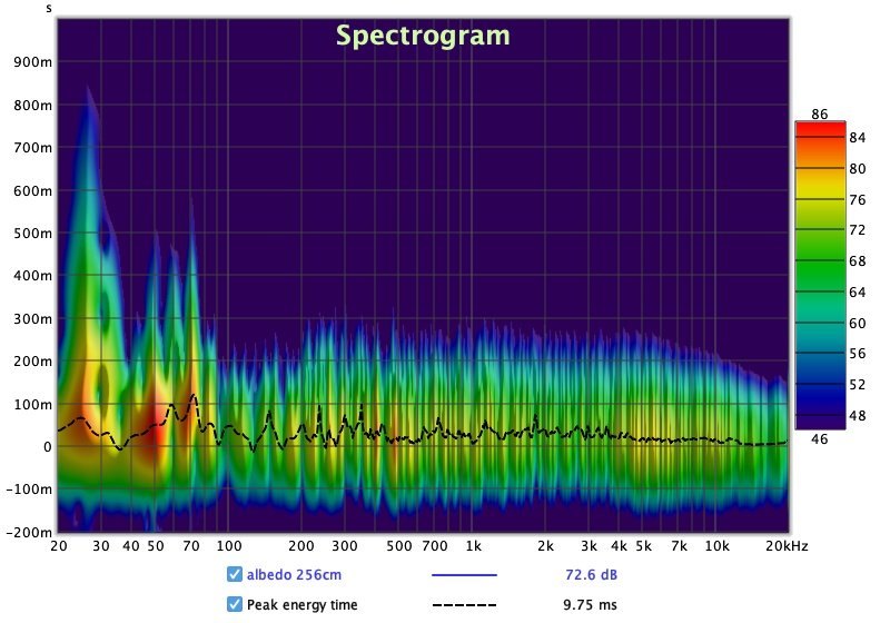

I suggest using spectrogram. It is the easiest one to read and I use it a lot to show my clients the problems, I like it more than waterfall when explaining. For example, one showing a low end decay problem and one mostly sorted out;
Reactions: ACHiPo
It is not the same as rt60, but in the end, it is always the same data presented in different ways. This and the waterfall are very good for inspecting problems and the effectiveness of solutions.

This more or less produces the same info in a different way ... is that correct

Frequency response and RT60 together are powerful tools. Individually you only get part of the picture.
Also, I use the Spectrograph plot quite often due to its simple clarity.
