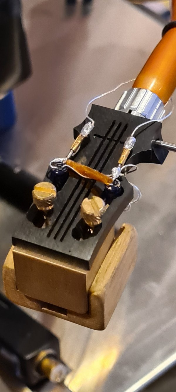

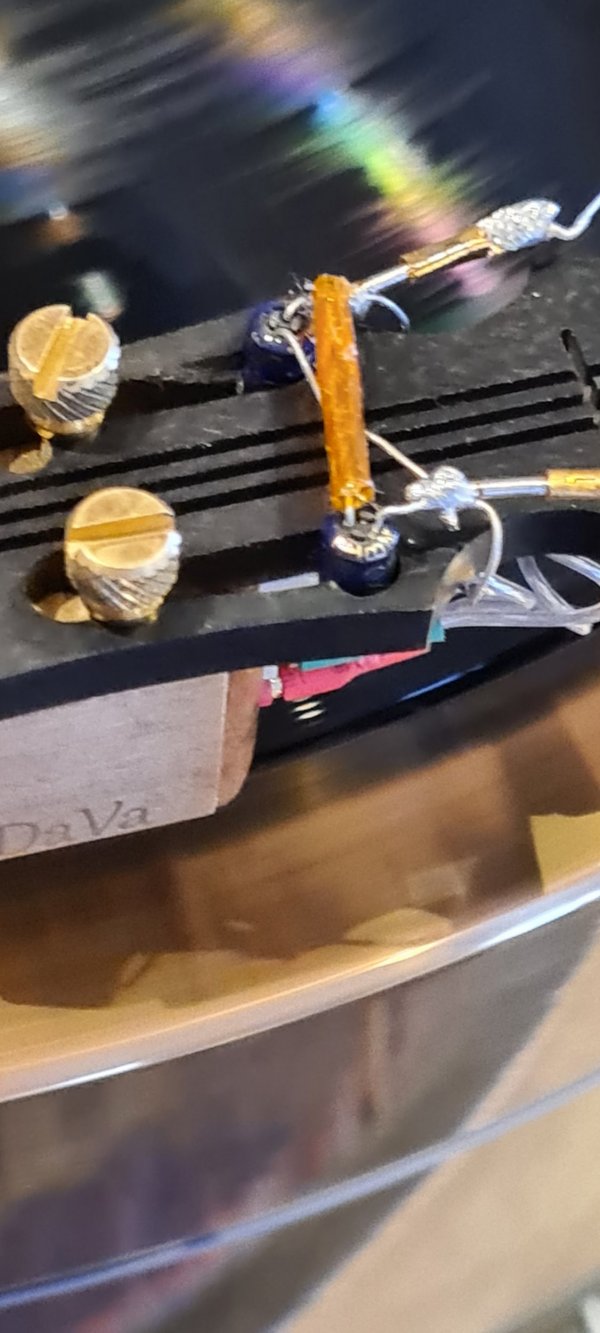

Rather than go the immediate caps on the headshell route with its dangerous soldering, I opted to try a 0.22uf bypass cap on the Audio Note. This is a Wima cap (modified by Ric Schultz/EVS), cheapo price but big benefit.
My soldering is certainly not the prettiest, but the sound is more resolved, instruments better separated and sound more like instruments, smidge of brightness gone, more open, hear deeper into the stage. This is not a huge upgrade but very noticeable and worth doing—and much easier than the headshell soldering challenge, which I still may get round to trying.

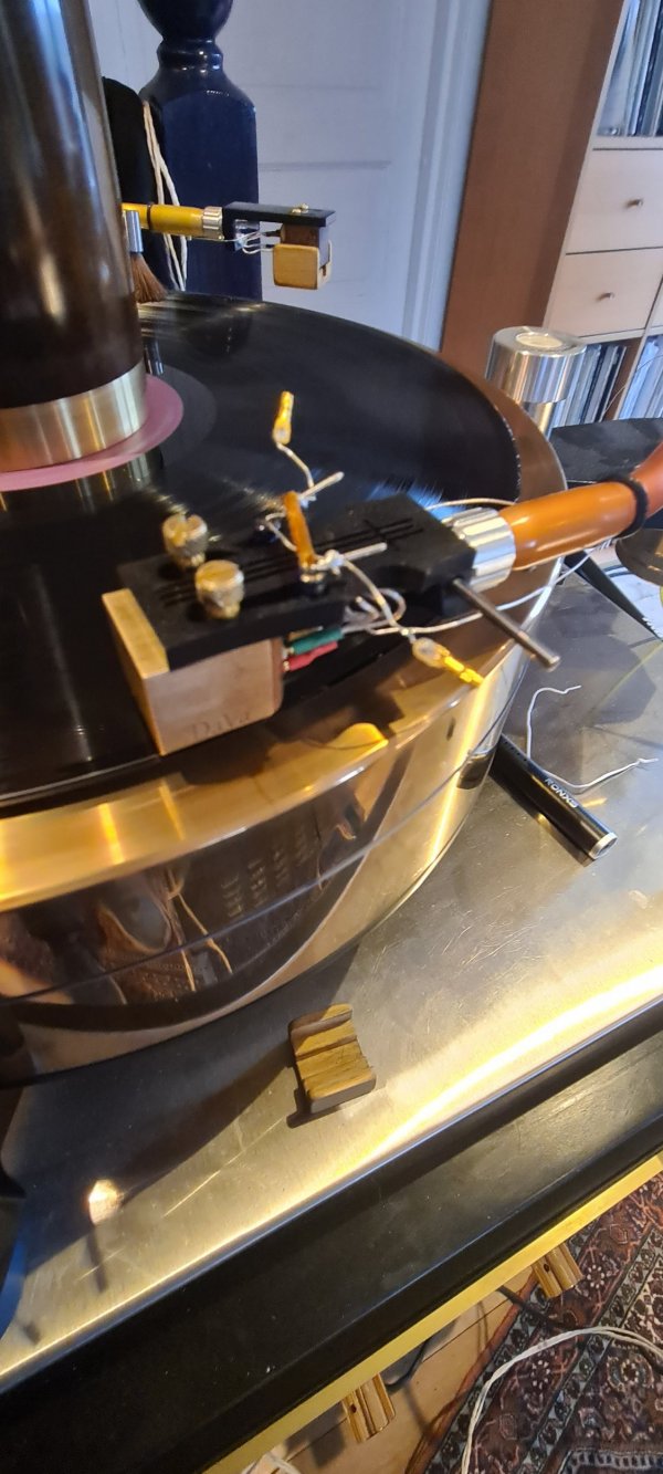

first without cap
then BGSuper E in the circuit

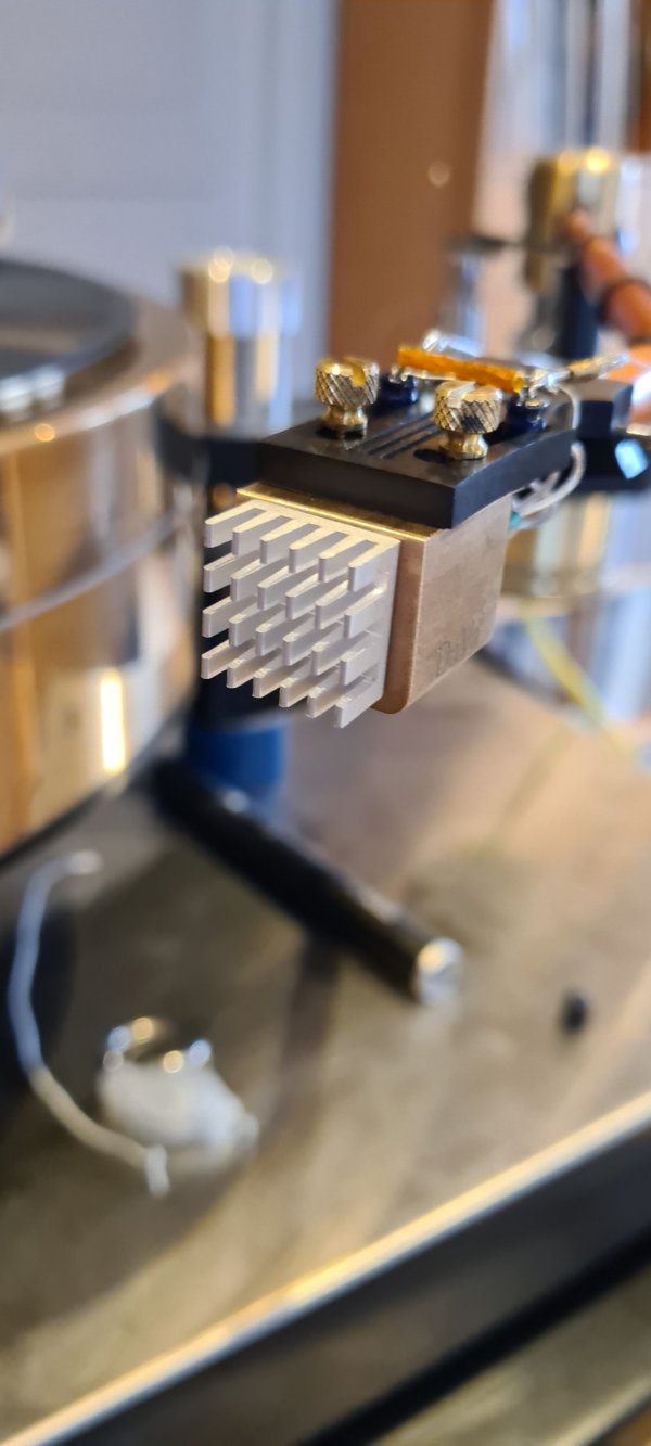

Leif, maybe I'm blind. Where did you mount the caps? Intuition tells me that we'd want them close to the cart.
Also, that heat sink is adding quite a bit of mass cantilevered over the front of the stylus. The performance of the cart and resulting sound is certainly affected by this and not only by the decoupling caps. I'm not saying whether that's having a good or bad effect, just that it's having an effect.

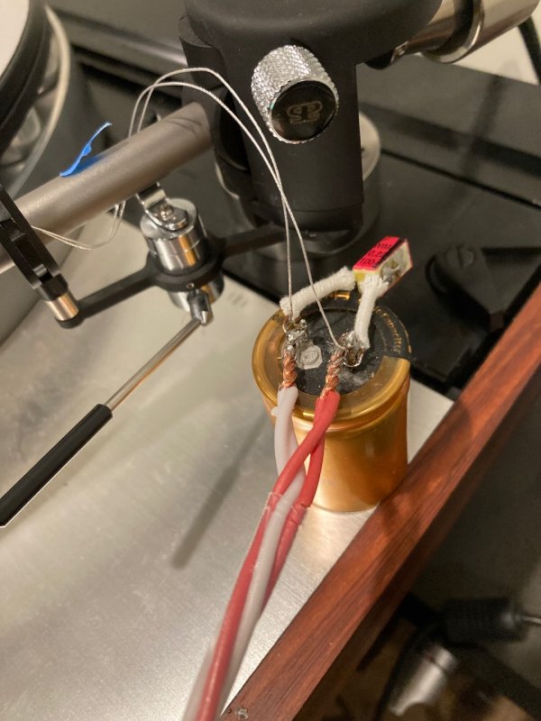

put a 0,1µF in parallell with the 10.000µF AN Kaisei too
even more dynamic energy
the heatsink was just a Viking prank to trigger Mike "DIY" Lavigne´s fear for this DaVa venture......not needed at all and just mounted for the picture..... :D

to sum it up: powersupply-Cardas 2 lead Litz copper-at base of arm AudioNote Kaisei 10.000µF elytic parallelled with 0,1µF film cap.....to follow Van Alstines decade shunt theory I should test to add 1.000µF in parallell too...Panasonic Fc is a good choice for musicality...will test after a couple of days at sea starting tomorrow

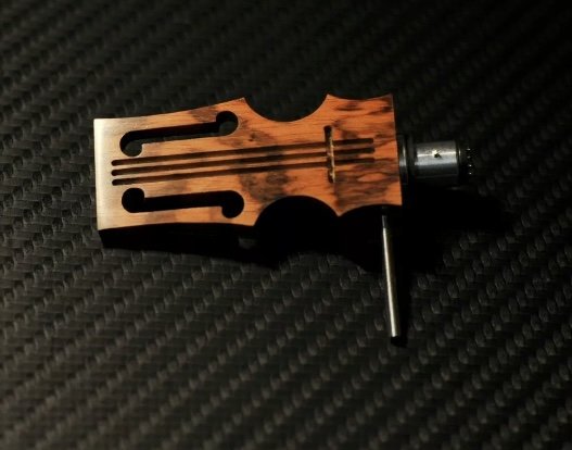

I think I missed the story on the headshell with violin look. Who makes it?
Reactions: Audiophile Bill
Head shell porn - hopefully arriving here tomorrow number 2. First one was Cocobolo - this new one is Snakewood.
Thanks. Quite a few options. Anyone try the carbon one? Or is the 'strad' the one :)
