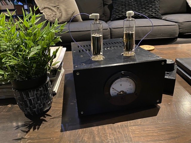

My damper diode PS build is just about done. I bored the hole today for the voltmeter. Adjustment rheostat is at the rear- I did not want to clutter the front.
A few more mechanical fasteners inside - but the design is done. Only now to wait for the DaVa cartridge, promised in September.
What range of voltage is everyone using? Darius says 9-12v max I can get up to about 140 mA into 93ohms at 12v
Here's hoping it was worth the work!

Excellent job. You’ll have enough wattage there. If you can be bothered, do consider a 2nd stage between this and your arm board - just one cap needed or a cap stack (see some of Leif’s suggestions).

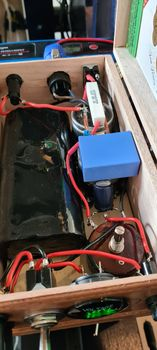

should my increased capacitance across the DaVA fieldcoil increase the current draw
I get nowhere near 40-50 hours play time from the 6Ah lithium battery
the measured coil R incl all caps is 93R8....
