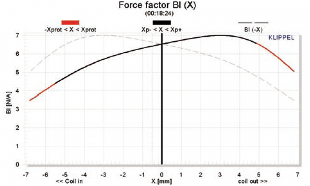

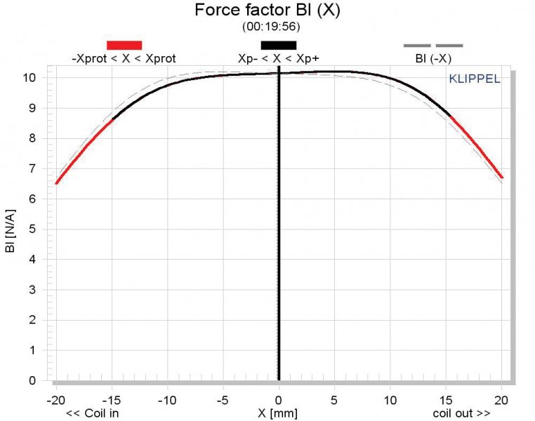

2. The applied driver's total suspension compliance and linearity vs its dynamic output in its dedicated bandwidth.
The driver's moving parts will be relatively harder to move when making larger movement. This starts with the QMS factor of a driver (eg. a softer spider and more flexible rubber surround) to provide a constant level of compression (this also applies to microphones). But then, most important for DYNAMIC compression, is its kms linearity (actual compliance, when inverted it is the cms number of the driver).
Good:
Bad (for this example, I compared a competion driver of the same size):
Basically the flat and symmetric (from 0) part is the part of excursion in mm that is without dynamic compression. Typically seen is a lot of dynamic compression in mid-range drivers on perhaps more pop/mainstream focussed speakers (B&W 800, KEF blade etc.) that don't apply a decently flexible surround around the membrane, allowing it to move freely. With such speakers, the louder you play, the more energy is relatively NOT used to larger parts of the output, so not ending up in the same relative air movement when comparing large sounds to small sounds (the small sounds, details, high frequency sounds, get highlighted). If the mid-range is relatively harder to move on larger excursion then bass and high frequency drivers, you get a "smiley curve" when playing loud. With simultaneously compressed detail entering the mix in mid-range.
These will sound good or (escpecially accaptable and forgivng) on mixes made for pop/radio or mixed of on something like is mixed off on short/mid-fields like eg. Genelec 8351 (which is however a very decent monitor for soundstage-checks), instead of doing so with proper main monitors such as found at the same brand in the SAM range. If you personally agree will still depend taste and finesse. Many might prefer this mid-compression behaviour, pending on the overall speaker dispersion vs room situation and personal taste. Personally I like a speaker that sounds such as good and in balance with low and high volume, including all frequency bands, and only sounds even better when considering the typical effect of the natural extra's pure db's being brought to the table (my ears). It also means that for top tier, we need to go for multiple drivers, each optimal in their own specific bandwidth application. And it has to sound right anywhere from fair living room system situations to top-tier-listening rooms.
The type of driver also is very important: Ribbon's, electrostatic panels, AMT's all have typically (but not necessarily) more dynamic compression than a membrane placed relatively free in a high QMS suspension (dynamic driver, moving coil), given there constructive nature. But also a compression driver, although having a more typical (inverted) dome membrane, usually depends on this type of higher-loss and less-linear suspension (wiki):
But there are more ways to low-compressed-Rome, if also counting other driver and enclosure, even taste, parameters: Its a about the mix being optimal towards the listener, more than what type of road/direction to choose.

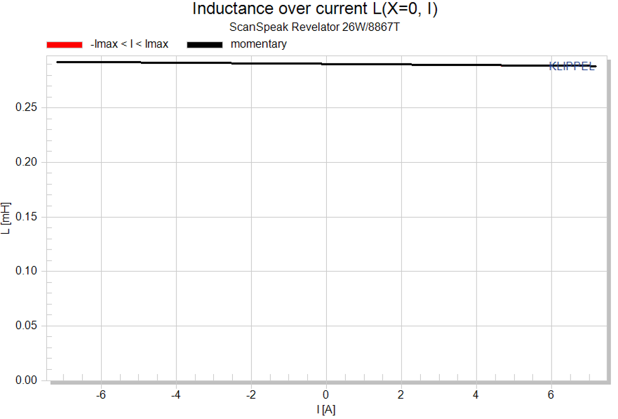

5.The self-induction of the driver and its linearity over excursion.
Drivers can waste a lot of energy in non-usable effects. There is the self-induction of the driver combined with the relative amount of energy going into eddy currents, and the overall linearity of these inductive effects over small to large excursion is a defining parameter when considering dynamic compression. Hence, if we want less dynamic excusion we want to minimize these effects. There are all kinds of things to use, such as symmetric driver, FEA optimized magnet dimensions/shapes, copper and alu shorting rings, hexagon/super-dense coil winding, material of coil former, etc etc. Too much to explain here now right away, but questions are welcome.
An excellent truly-symmetric driver (using a lot of additional magnet/constructive material and copper, hexagon winding and fully saturated magnet):
An equally excellent driver using FEA motor and shorting rings and special coil former material (see for comparison to above only +-7mm on the bottom scale):
The second is a bit lower in overall self-induction, but a bit less linear. Both have the ingredients to sound top-tier in larger driver's. In smaller driver's sound the flatness becomes more important, and a even far lower amount of self-induction is desirable. And no, it also doenst come done to choices such as underhung vs overhung. It's far more complex than anything of such black and white comparisons.
