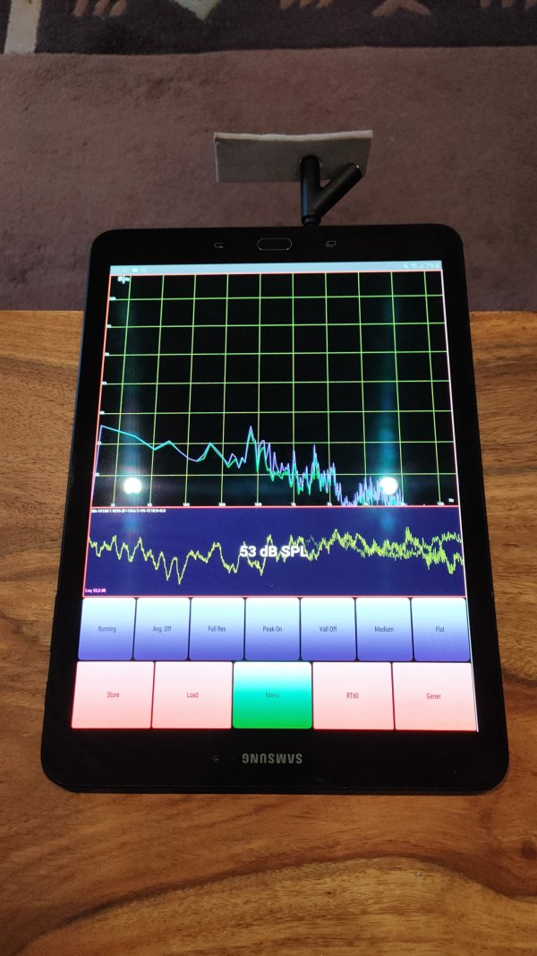

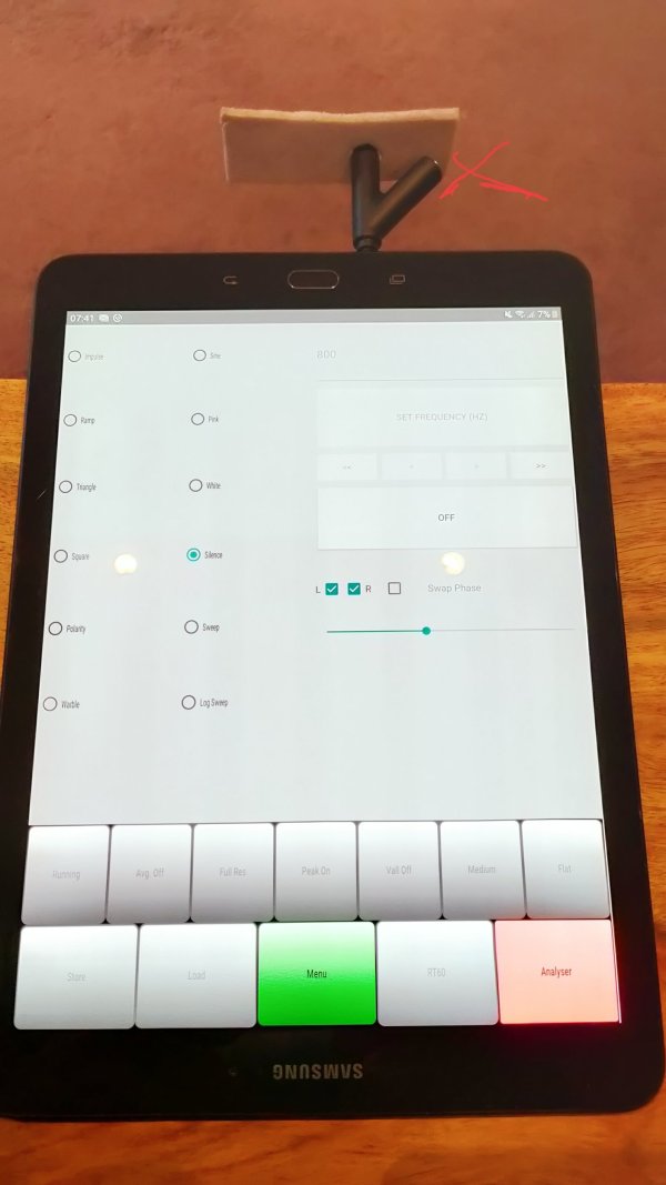

Audiotools actually has its own tone generator and can play all sorts of noise. :)
Of course milan,
what you need is callbirated microphone with 3.5mm output to feed your system
Either with USB/C or jack for your tablet/mobile phone. A long 3.5m to RCA cable.
Exsample dayton imm 6c available for both inputs
On the back of the packaging is a serial number. Go to the Dayton website and download the calibration file and install it in Audiotool. Your measurement system is ready.IMG20250719074224.jpg
