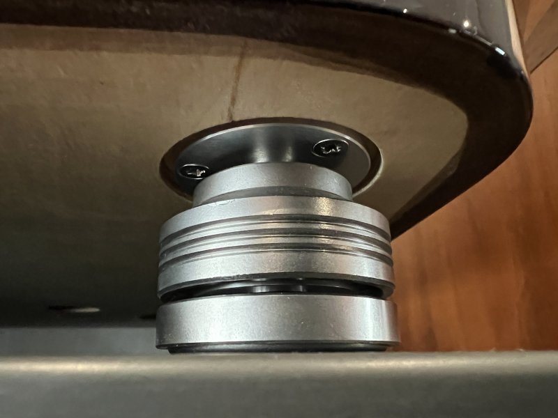

I wanted it flush. The photo shows it too low. I did not want the assembly to sit on top of the plinth. A good decision because the gloss finish (16 coats of lacquer that took five weeks) is fingernail thick and very easy to crack and scratch. Putting the assembly directly on top of the lacquer would have been a bit scary.
I've now raised the assembly a few mm with sorbothane strip all along the mounting groove. Given that the CTC 301 bolts from underneath, the assembly is now isolated from hard contact with the plinth. I also raised the platter 2mm (the bearing has height adjustment). I spray painted the feet a metallic grey to get rid of the shiny aluminium. So a couple of hours tweaking.

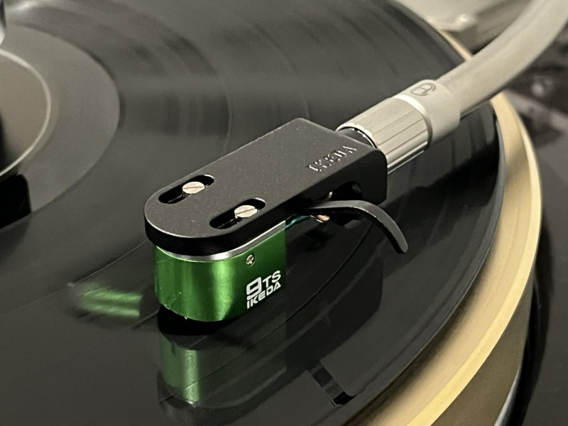

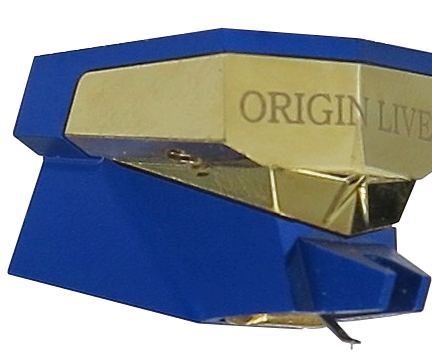

I've not directly compared them. Years ago I decided to use a second arm for mono and a cheaper MM for less good quality records and some casual listening. I had a nice/OK Goldring, but now for a very good MI cartridge (Soundsmith/OL) running into the Luxman 509X internal MM phono amp.
That cartridge did not fit on the Groovemaster headshell, so I put a Denon DL103R (Expert Stylus upgraded) on it and got a Phasemation headsell for the Soundsmith/OL.
For the Reed 3P I have a Koetsu Urushi rebuilt by Dominic Harper (NWA) with a Fitz Gyger cantilever/tip, I have a DV XX2Mk2 as a spare. I'll be in Japan in a month, may pick up an Ikeda 9TT.
The Groovemaster III with the Soundsmith/OL cartridge performs really well and it's beautifully made. It doesn't have that last bit of fine detail as the NWA rebuild, but I could listen to it all day. It comes in a load of options and lengths, which is useful, I have a 240mm version. There is a new Groovemaster IV, which ends up almost double the price.

The Groovemaster was meant to be a secondary arm, but it's very good, I spoke to James Henriot at Whest and he did me an excellent deal on a Two.2 Discrete phono and a few weeks ago when in Japan I bought an Ikeda and headshell. So it has ended up being on a par with the other one.
