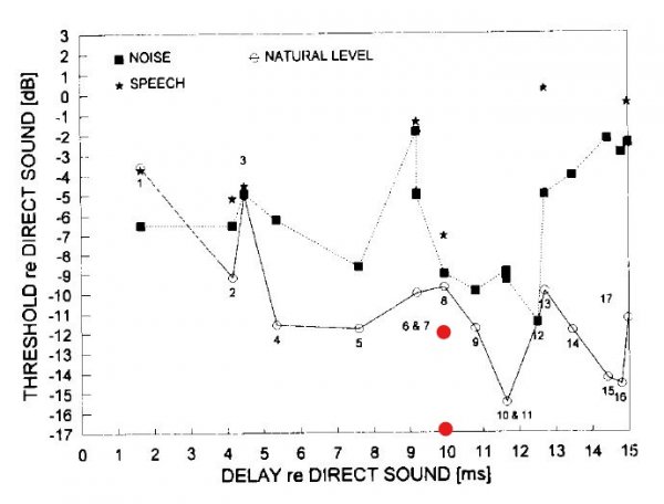

I add Bech’s graph on detection thresholds of early reflections. I Think you will agree that in order to have an effect, positive or negative, a reflection has to be above threshold, so these thresholds indicate the potential of the respective reflection to take an active part. As the graph clearly indicates there is no correlation between delay and potential. As the graph further indicates thresholds for most of the reflections are above the natural level, hence not audible, which is good news. Bech made his experiments in a domestic size room of 7.52 x 4.75 m. The caveat is that he used a single loudspeaker/single reflection/reverberation setup and did not use music. But still, the statement that the earlier the reflection the worse it is, is not supported by the facts.
I could find only one research where music was used, detection thresholds for different reflections were obtained for a single loudspeaker/single reflection setup in an anechoic chamber. Only one of those reflections is (almost) identical to one of Bech’s, so I’ve extrapolated the lower and upper thresholds, which depend on music motive, to Bech’s experimental conditions and added them to the graph. That extrapolation obviously might be riddled with errors.
So we have powerful reflections at 17 milliseconds being detrimental to clarity in the concert hall, and weaker but earlier reflections potentially being detrimental to clarity in home audio.
The earliest reflections in home audio are generally from floor and ceiling, but coming from roughly the same direction as the direct sound, they are masked and detection thresholds are high.
The geometry I currently use typically results in 10 milliseconds delay with the speakers about 1 meter out into the room, as the rear-firing array is angled upwards at 45 degrees such that we get a wall bounce and a ceiling bounce before the "backwave" reaches the listening area. The spectrum of this energy is user-adjustable so some adaptation to different kinds of surfaces is possible.
If I place your speaker in our living room with the current setup of furniture (speakers along the longer wall) as indicated that wall-ceiling bounce would be delayed by 11 ms. Maybe you should write a white paper for your website explaining the psychoacoustical background of your concept.

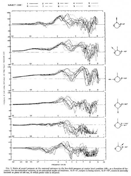

Further, differences between individuals are substantial, see graph below, and that’s why I consider subjective impressions of others of little or no relevance, their pinnae might be different.
Agreed that pinna are different between individuals. Don't agree that "subjective impressions of others of little or no relevance" - to me, when there is a critical mass (or if someone whom I have found in the past shares similar evaluation) of anecdotal reports pointing to an audible improvement, I pay attention & try to evaluate for myself or put on my list of things to investigate

Agreed that pinna are different between individuals. Don't agree that "subjective impressions of others of little or no relevance" - to me, when there is a critical mass (or if someone whom I have found in the past shares similar evaluation) of anecdotal reports pointing to an audible improvement, I pay attention & try to evaluate for myself or put on my list of things to investigate.
