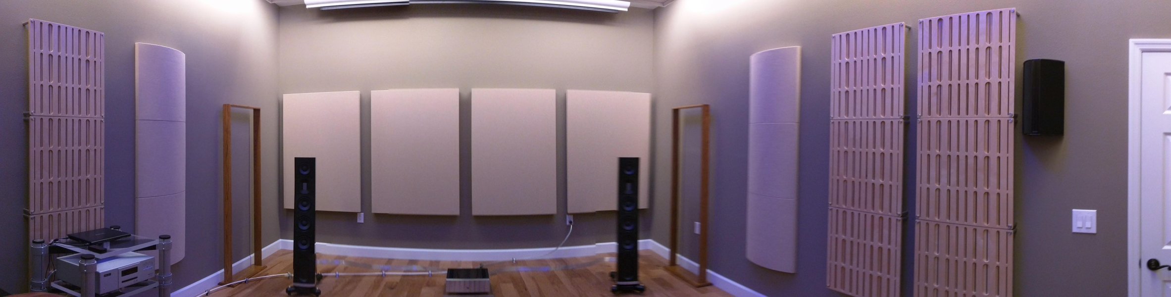

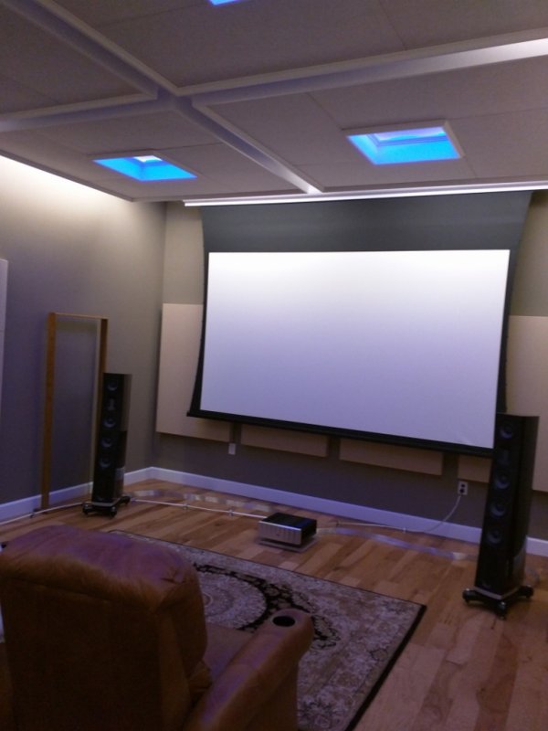

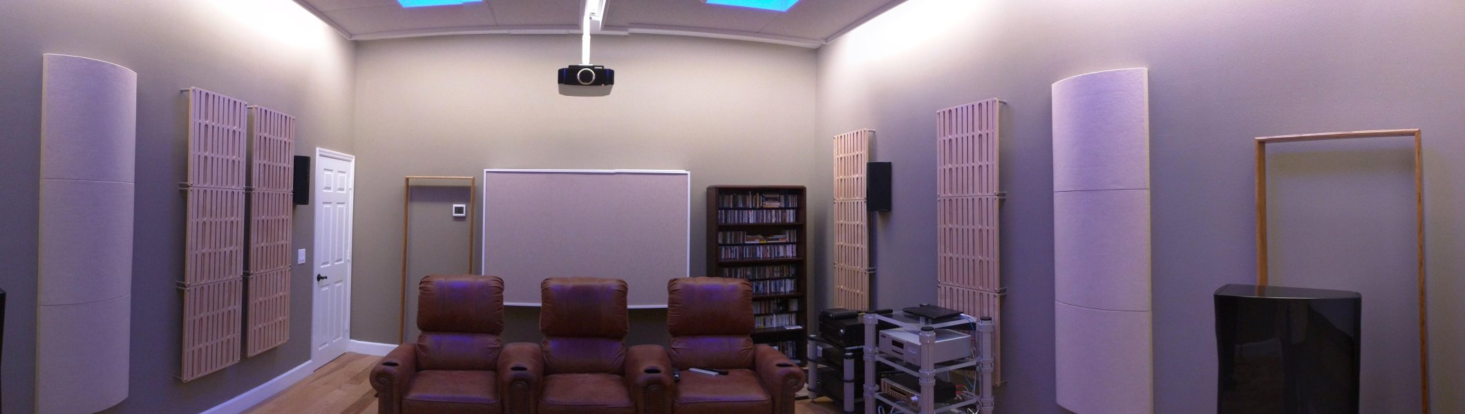

I have a 2013 JVC projector and a motorized DA-LITE 16:9 Projection Screen in my media room. The projector automatically displays both 1:85 using the entire screen, and 2:40 with black bars and top and bottom. I actually prefer the 2:40 ratio because of the wider angle. The black bars are pretty much invisible in a darkened room.
Listening Room Front Panoramic (1024x294).jpgListening Room Rear Panoramic (1024x294).jpgIMG_20160504_105921 (768x1024).jpg
