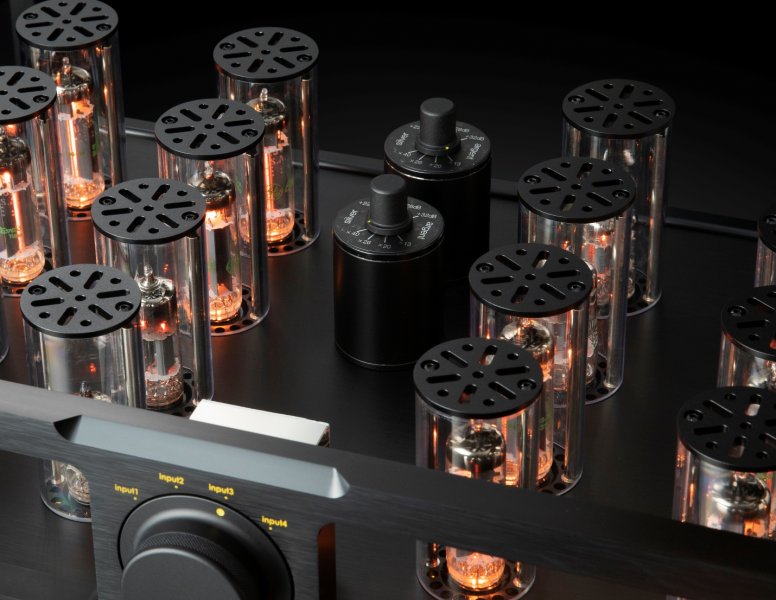

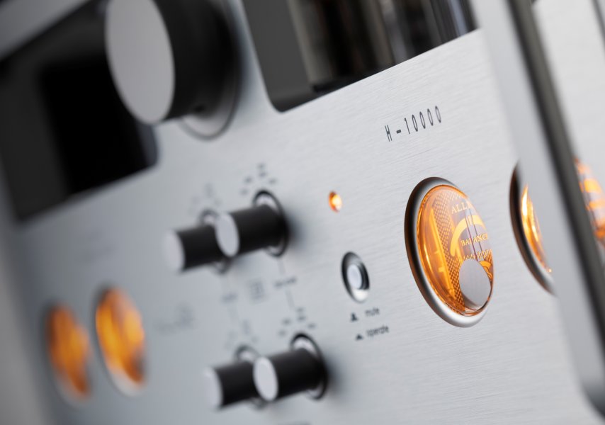

And for 2024! Finally released: the H-10,000 OTL/OCL Phonostage!
In general, OTL/OCL means no barrier to high-frequency extension and no apparent limits to low-frequency reproduction. OTL/OCL also demonstrates no loss in mid-ranges—Korean, European, and N. American customers uniformly are delighted with the unprecedented wide ranges without midrange sacrifices. "Its richness in the mid-bass is (Expletive) awesome and great focus (on the) artist with 3-D presence."
Anticipate one or two print reviews in 2024!
