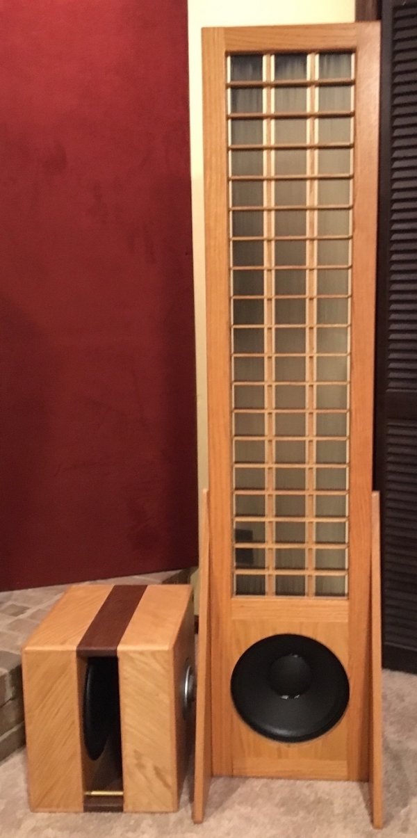

I can't say that I've ever heard a "perfect" speaker but... yes, I can say that my speakers are perfect for me. That is; balanced, sufficiently dynamic, and spooky-real clarity. And the fact that I designed and built them myself is pretty rewarding too.
I've been a music lover and wanna-be audiophile for as long as I can remember but I never had the financial freedom to indulge my lust so I had to innovate, spend wisely, and build whatever I could.
My fully-dipolar hybrid speakers evolved over 15 years researching and building many iterations of electrostatic drivers. The wire stators are 90-wire arrays, electrically segmented in 15 discrete wire groups to function as a line source projecting a cylindrical wavefront. This arrangement gives wider, smoother-trending dispersion than a curved-panel ESL, and the DIY Ripol subs are the perfect match to complete the package.
A full description with build photos are given on my website here:

View attachment 121650View attachment 121651
I'm wondering if that's a commercially marketed speaker or a one-off that some very talented person built. I'm guessing it's electrically segmented (otherwise it's flat panel would be very beamy). It's a beautiful speaker, driven with a valve amp and it probably sounds as good as it looks!
It's pretty common to segment wire-stator ESLs to widen the dispersion pattern but most commercial ones (Audiostatic comes to mind) add a separate/narrow tweeter segment or [at most] separate midrange and tweeter segments. Three segments are sufficient to eliminate the "head-in-a-vice" beaming effect, and it's less labor and cost than adding multiple additional segments.
My panel is symmetrically segmented about it's centerline, using 15 six-wire groups--- consisting of a single 6-wire center segment for the top octave, and seven left/right paired segments on either side, in 7+1+7 symmetry. This arrangement produces a cylindrical wavefront with smoother trending dispersion than would be achievable using fewer segments.

Your description is far too technical for me. I've only owned 2 ESLs. I didn't like the Martin Logan Expression 13A (more accurately, it didn't like my room), but for some strange reason, the QUAD 2905 (with 2912 mods) sounded pretty amazing in exactly the same position.
