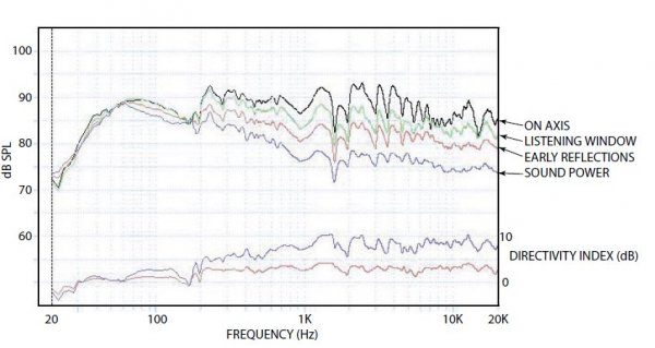

For hecks sake, let's LOOK at the measurements that are causing so much eyebrow rainsing and justifications (like having no resonances, in phase and therefore immune from the evils of the room etc and indeed all other speakers)
attachment.php
Look, FULL of resonances, every sudden peak and dip IS an abrupt phase change. Right smack bang in the middle of our 'sensitive zone'....the magical midrange of the speakers indeed. It is all over the shop, there is *nothing* hi fidelity about it.
So it satifies NONE of the caveats Roger Sanders talks about in the quote given (for completeness, howzabout we compare the measurements of Rogers speakers to speaker M?? Anyone got them?)
But, as we know, there are things science cannot measure, and that the ear is the most exquisite measuring instrument in the known universe.
COMPLETELY impossible that when heard blind against something with even a modicum of better engineering the other might be preferred.....
