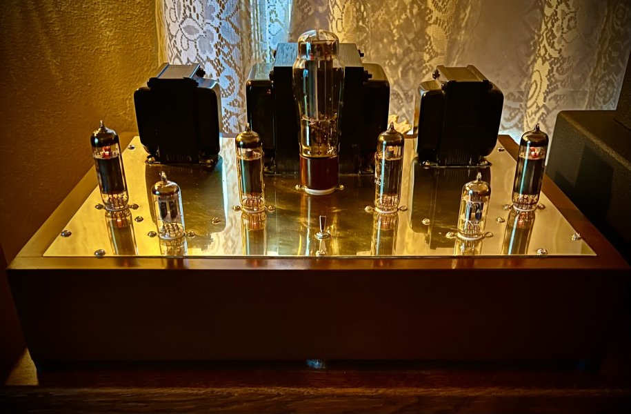

It's no wonder why he likes that integrated as it uses one of my favorite pentode tubes... the EL-84. My custom amp shown below uses german EL-84's; Mullard rectifier, and I switch between mullard and tele's for the12ax7's. The sound is fantastic! Incredible body, harmonic textures, dynamic. No slowness, no mushiness. It's an amazing little amp!
Best wishes to all for a very happy and healthy new year!
Don
Don, what amplifier is the one in your photo? Is it a custom build perhaps?
Hello,
Yes, it is indeed a custom build. I built this amplifier decades ago with the help of my great friend ( he goes by SET12 on AudioKarhma, etc ) He is an electrical genius and has built many great sounding tube circuits from MC/MM phono stages, pre-amps and power amps (both single ended and PP) as well as massive outboard crossovers for speakers.
I built the wooden frame and did the custom brass top plate. We utilized the vintage iron from an amazing Pilot amp that I had. The circuit was inspired by Pilot Corp, but he enhanced the dynamics, speed and the power reserve. We used bespoke capacitors and carbon resistors and massive Cardas copper binding posts. I'm using NOS Vintage German EL84's, NOS Vintage Mullard Rectifier, and alternate between NOS Vintage Mullard or Tele drivers.
This was an all out assault on building the best sounding EL84 amp that we could at that time. He did the schematic and he sat at my side, coaching me while I soldered away - all hard wired, point to point, no circuit boards whatsoever. It was a great experience working together side by side... doing all the bread board trials, the A/B sessions, tweaking the circuit, experimenting with different resistors/capacitors, etc. Something that I will never forget and will always treasure forever!
This amp plays with so much beauty. It's rich in sound texture, but not syrupy; it's explosive in dynamics ( both in the micro and macro sense ) it's fast and it plays with intense emotion. It sounds so much powerful than what it's power rating would imply. I'm in awe with it every time I listen to it. In fact, I'm listening to it right now as I type this :)

Hello,

Looks fabulous!
EL84s are at just the right power level where the output transformers can really shine and show what push-pull can really do. I expect such an amp, properly designed and built, will put any SET on notice.
Dynaco made something like that called the ST35. Fixed up properly they can be surprisingly musical. I've seen them take out SETs costing quite a lot more.

Looks fabulous!
Thank you, Ralph!
I absolutely love my custom EL84 amp! You are right about it being able to put SET's on notice. It has indeed humbled several very costly amplifiers over the years.
Wowza, the Dynaco ST35 is a flash from the past. I had one that was refurbished decades ago powering my Klipsh Kornerhorns and it was indeed very musical. It seemed to pair very nicely with my Walnut K-horns.
