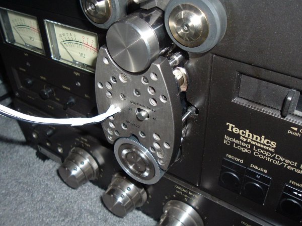

Was "auditioning" a new playback head in a Technics 1500 headbock. A/B'ing IT versus the stock Bogen in my MCI. Using a dub of the Four Seasons (Handel vs Frankie Valli) that I knew had very good imaging, especially depth. Imaging on the "new" head was definitely "restricted" front to back. Chalked that up to the head until I thought - hey, I've experienced this with absolute phase on my Quads before. Maybe it's a phasing issue. Swapped the leads to the speakers and the depth was restored. I must have connected the new head in reverse phase with the "stock" Bogen.
Takeaway from this is a question and a comment. The question involves if there was/is any kind of "standard" regarding tape deck phasing? Can't say I ever heard of one. Comment is maybe that absolute phase switch on the preamp IS useful.

Interesting subject, Charles.
In my limited experience, I find out-of-phase signal output on a machine during the initial azimuth testing. Usually it will be a well used machine that heads were replaced in a hurry by a studio tech and the head would be wired reverse. I see the 180 deg out of phase Lissajous Patterns immediately even at the rough 8Khz test tone.
With the out of phase repro head, there will be no imaging to speak of... I would record pink noise and play it back on a properly finished machine, and it is eerie to my ears to hear the small "ball" of noise floating in between the speakers that would be spread out widely across in between the speakers before getting the repro head output in phase. Fun stuff indeed.

Lee, the issue I had described above is more common on 4 track consumer machines. Have two Akai machines that came with near 90 deg out of phase repro heads...
Ki

I find that absolute polarity, which I think Charles is talking about, is something I can hear most of the time. I understand that many people cannot hear any difference. What I think makes a difference is often the speakers one uses. Often speakers have different drivers wired out of phase with each other (by design) so that it is difficult to hear absolute phase. Also many multimiked recordings will have different mikes out of phase with each other.
I have an absolute polarity switch on my preamp (Herron 3A) where I can flip polarity remotely from my listening chair. I also have absolute polarity switches on my TT (custom wired) and on my Pacific Microsonics Model Two for ripping and playing back digital files.
I have found that most vinyl is recorded with reversed absolute phase (in particularly British Decca and EMI classical records). Not sure about prerecorded tapes. I asked Paul Stubblebine about the Tape Project tapes and he said that he checks to make sure that the absolute phase is correct in their releases.
