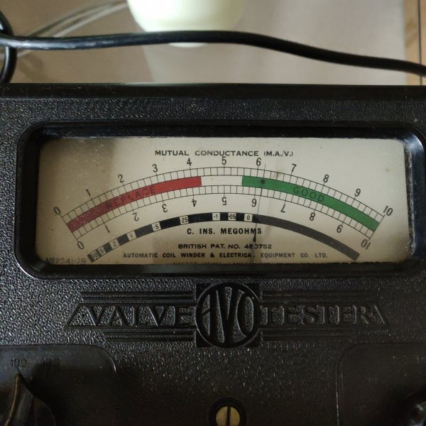

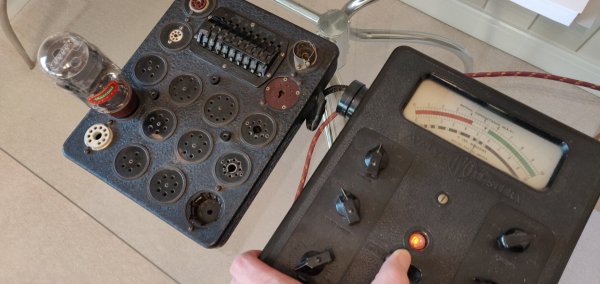

As promised the AVO meter readings.
New spec is 6mA/V and these come in at 6.2 and nearly 6.4 mA/V. Excellent and very closely matched. They are also rock solid stable in terms of output. Not always the case with old valves. The seller has an excellent feedback rating. It looks deserved.
If you look down inside the valve, you can see it is brilliantly simply made. No heater insulation simplifies it further I suspect.
My guess is this simple construction is why microphony is so low, which it undoubtedly is.

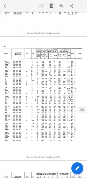

The base in the AVO data manual is described as 8SC. This is not common. It seriously constrained what the valve could have been used in.
As a result, I reckon it is far more likely that valves with this socket have not found an application over the years. Hence the above measurements.
