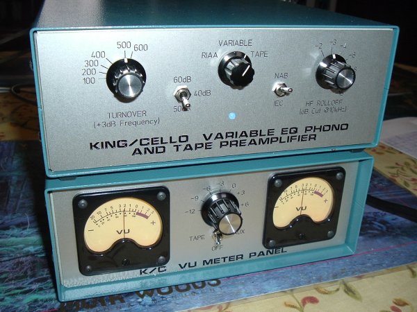

The "new" K/C preamp pics that U47 posted are of a "one off" unit that I made for a customer in the Philippines. It is the original design in different clothing - what I refer to as the "Cello box". The only changes I've made throughout the "production run" of the pre are to bypass/eliminate the output capacitor and the type of one capacitor. The design won't change; I'm not capable of improving it and really don't think it has to be. It was originally unbalanced in and out and will remain so (tried balanced out and failed).
The VU meter panel was provided at the customer's request. Once you wire out a head you lose the capability of using the deck's built in meters. Problem with that concept is what size to make the enclosure - which kind of depends on / forces one to decide where you're going to put it. My latest two customers want it and we've agreed to try putting it in a box the same size as the pre itself. Found some really cute!!?? VU meters (only a few folks in the world make these anymore). Will post pics of the finished product. The panel helps provide some "focus" for those of us (including myself) who listen with our eyes.
Found some nice, small VU meters that would fit in the "standard" Pre / power supply cabinets.
Now a customer is inquiring about a monitor panel - two small speakers / amplifier in the same sized box. We'll see.
Charles

"2016 UPDATE TIME"- here is the "latest" "Swiss Army Knife" K/C preamp. A combination of features I made individually for a few customers and retrofitted to an early customer's tape pre.
RIAA and Variable phono (for those toying with 78's and early LP's) and NAB/IEC Tape.
Will see how the customer likes it! Includes the separate VU meter panel that plugs into (and derives power from ) the pre itself.
OK,
