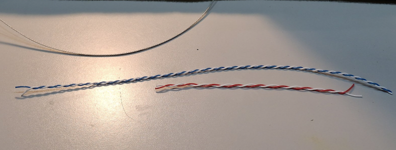

Thank you for the very helpful recommendations. I tightly twisted the connecting wires in a drill and then inserted them in a grounded shield braiding. I considered placing all of the wiring inside copper tubing, but will want to do some additional testing before I try that approach. For me, this project is a working test bench, a way to see how the different calibration adjustments effect each other and how they sound in comparison to a reference. I designed the enclosure so each panel is removable to give easy access to any part of the construction.

So it looks like you are not switching between the different EQ's, but adjusting as you need. I then presume you are going to use the ten-turn dial on each one, so you could quickly return to the desired EQ?

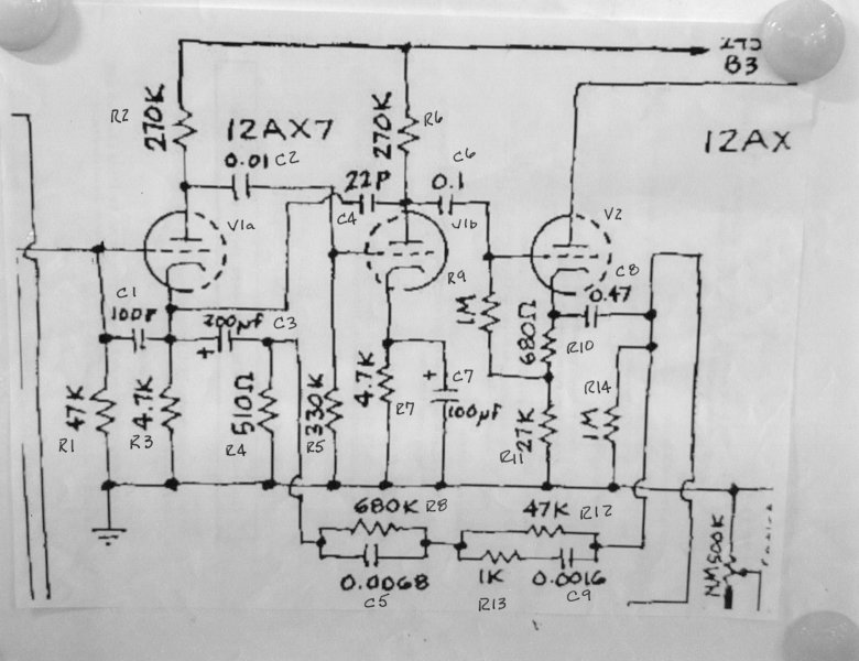

At this point I'm concentrating on an NAB 7.5 response for this project. I enjoy searching out those vintage London and RCA tapes made in the late '50's and early '60's that have some amazing sound qualities. My principal listening test tape, for this project, is the 1958 London recording of Britten's Peter Grimes. The recording technique they used involved placing the chorus and singers on a stage that had been marked with numbered squares. Each performer was positioned in a specific location after testing how it related to the stationary microphone "tree". Then as the scene in the opera required the singer would move to another marked area of the stage. So if, for example, the Peter Grimes character moves from stage left to the rear of stage right he would continue his dialogue and walk to the assigned area. The result is a palpable recreation of a sound palate with the chorus, singers and orchestra. While I'm sure this was done to highlight the then new "miracle" of stereo sound it meant that spatial clues could be preserved.
