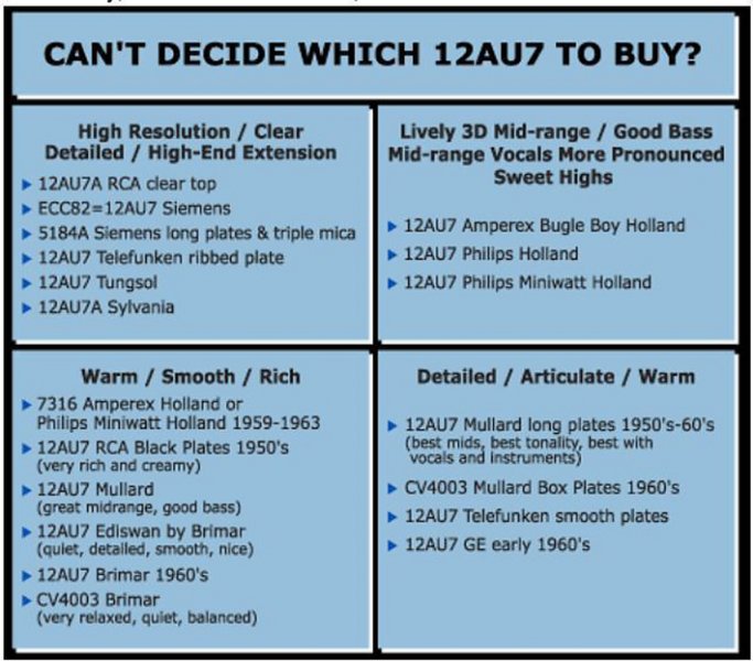

For 12au7, if you can accommodate the extra heater current of e80cc then I would use that and swerve the options listed. Only made by Philips or Tungsram, the latter is better and cheaper.

Brimars add a lovely warmish timbre with good highs.

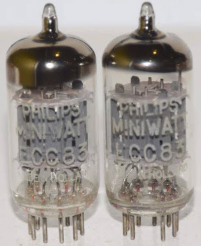

Eventually, I could get my hands on Philips "Miniwatt" ECC82/83, but there is no further information, yet.
The early-60s Philps Miniwatt ECC83 is definitely worth seeking out. Another brand I like is the Westinghouse JAN 12AX7, circa early 1960s, yellow writing.
If you are willing to purchase from an US dealer, consider Tube World Express. Dealing with him for over 20 years, I can say they are an honorable seller and very accurate in both grading and sonic description. I purchased 2 pairs of the Philips Miniwatt a few months ago. They are not always available but show up regularly.
Great tubes, I have a couple of pairs myself as well as ECC82's.
It should be noted that the Heerlen Holland Philips factory was also where Amperex was manufactured. The 1960s Philips Miniwatt and the Amperex Bugle Boy are identical tubes with the same tooling. This generation (1960s) Miniwatt and Bugle Boys have a more extended top-end than 1st generation. The earlier produced tubes (1950s) have long plates and a large halo getter while later production has a small halo getter. Nevertheless, all Amperex/Philips will produce a huge soundstage and warm, liquid mids.
All have white branding on the bottle with a delta symbol indicating Holland factory followed by the date code.
Amperex made in the US don't have this symbol and have a more forward sound than the Holland.
