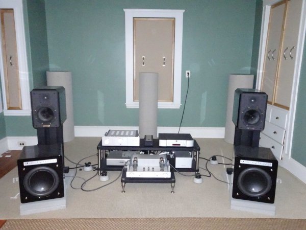

I had long resisted a move of the subwoofers away from the front wall for several reasons, apart from the above contradictory messaging:
1) as audiophile friends have acknowledged, rhythm & timing of my system has been excellent
2) I found the bass on a lot of material very precise, also compared to other systems, except on one type of material (I'll get to that)
3) as much as I tried (and I did!), I have never been able to hear any time delay between main speakers and subs, e.g., on drums (kick drums and others), and neither have others whom I asked to listen for it
4) I knew that the ASC SubTraps, which my subwoofers stood upon, were hugely beneficial for the sound, and I hesitated moving the relatively high stack of SubTraps plus subwoofers closer to my main speakers because of an expected detrimental effect on soundstaging.
Yet the issue came up again from time to time, such as in the comment of Brad (Morricab) here, which I replied to further below on that thread page.
Ultimately I decided that it would be worthwhile trying to move the subwoofers upfront, but then only under one condition. I would not use the SubTraps since they would be in the way, but I would have to find somewhat of a substitute. I decided to put the subs onto concrete plates, as I also have them under my monitor stands. This would avoid direct coupling to my suspended wood floor, which I knew was disastrous, and if I used two plates instead of one (4 inches total thickness) it might raise them sufficiently from the ground as well, so that the subs would not excite the wood floor right in front of them too much.
Yet then the pandemic hit, and I forgot about the project. After all, I did not have the concrete tiles necessary, and I was not going to go to Home Depot at that time (my health was too important to take the risk). Thankfully, a recent suggestion by Charles (Chops) on my thread reminded my again of the idea and so finally I went to work, now that in our state of Massachusetts the pandemic is much more under control. I bought four 16 x 16 inch concrete tiles at Home Depot for a whopping 17 bucks total, and then moved the subs together with Peter A. who had graciously agreed to help. With two persons, moving those heavy subs of 110 pounds each is actually easy, whereas JL Audio sternly warns against trying to do it alone, also because of the potential of back injuries.
The first spatial arrangement was this:
While there did not seem a sonic disconnect between subwoofers and main speakers, the bass did not seem quite right. It was less tight than before, and some frequencies, e.g., related to the impact of kick drum, were weaker. Another issue was that now -- something that I had not considered when planning this arrangement -- the main speakers would partially radiate onto the glossy surface of the subwoofers beneath them, possibly creating detrimental reflections. Peter suggested that we could get the subwoofers more out of the way of the main speakers by putting the subs next to the speakers. We could do this if we moved the main equipment rack further back.
In previous times I would have objected to a rack move because I did not want to get the equipment more in the direct fire of the sub bass, but since the subs were now in front, I welcomed the idea. So we moved the equipment rack 10 inches further back, also the amp rack, and moved the subs next to the speakers. The drivers now are about 4 inches in front of the main speaker drivers, and since they are closer to the listener, the measured sonic path to the ear is 6 inches shorter.
Now the bass was better than with the first arrangement with subs in front of the speakers, and in some ways I heard also better bass than with the subwoofers at the front wall. I'll get to that later.
Here is the new set-up (sorry about the whitish stripes in the pictures, they are reflections from the flash, cold not avoid it):
So how does it sound? That's going to come up in my next installment, tonight or tomorrow.

As I mentioned above, the initial arrangement with the subwoofers right in front of the monitors did not yield satisfying bass; the second and current arrangement with the subwoofers next to the monitors did. Yet I had forgotten that the subwoofers had been optimized to the position on the front wall with D.A.R.O. (Digital Automatic Room Optimization) by calibration using a microphone:
https://jlaudio.zendesk.com/hc/en-u...Digital-Automatic-Room-Optimization-D-A-R-O-#
This calibration had not changed upon the subwoofer move, and probably makes the assessment of sound with the initial arrangement, featuring the subwoofers right in front of the monitors, invalid. Yet of course I still could recalibrate for the current arrangement. My first attempt was marred by noises from the open built-in wood cabinet to the right side of the listening seat. During the calibration, the bass test tones from the subwoofers that would be picked up by the microphone are very loud, with wild excursions of the driver membrane that just do not occur upon normal listening to music (you usually don't see the membrane move). They caused something inside the cabinet, apparently in or behind the wood, to rattle very loudly, a noise which would have had to influence the calibration.
So I decided at first to run the subs at standard setting, without DSP using calibration via test tones. The kick drum on the wild, energetic jazz rock of the Trio of Doom (John McLaughlin, Jaco Pastorius, Tony Williams) was still rather weak. Also, while the heavy synth bass on 'Bad Guy' by Billie Eilish sounded clean and tight without subwoofers, there was some smearing with the subwoofers turned on. Both those things were a setback in sound quality from the original subwoofer arrangement at the front wall, a few feet behind the speakers. There were advances, like the bass now going much deeper at 2:30 into the Billie Eilish song, and other things, but it was not optimal.
Then I decided to try to tackle the calibration problem. I brought back the large absorbing panel (8 x 3.5 feet) that until recently had been in the middle of the front wall, and put it in front of the open built-in cabinet. The rattling sound was completely gone, and I could complete the calibration. While this 2 inch thick absorbing panel would somewhat influence the midrange and high frequencies in the room, the influence on the bass in the room should be relatively negligible. -- There was still some rattling in the right hand rear corner of the room when I calibrated the left subwoofer, but this was relatively minor, and probably even less than rattling during my calibration of the subs when they had sat at the front wall.
With calibration successfully accomplished, and the absorbing panel once more removed from the room, I was listening again. What a transformation of the bass! Now the kick drum on the Trio of Doom recording was strong once more, and the precision of the bass surpassed the already high level of performance that I had heard with the subwoofers positioned on the front wall. Small accents in the bass were now audible that I had not heard before. You just don't know high precision bass until you hear it. The bass on 'Bad Guy' by Billie Eilish kept sounding clean and tight also with subwoofers on, but now with extra power over the already prodigious bass with monitors alone, and going much deeper than the monitors; you could feel it in the gut. The freakishly precise repeated start/stop of the deep bass in the passage starting at 2:30 is just amazing.
Given the vast difference in bass quality with and without DSP through calibration by test tones and feedback to the subs by microphone (D.A.R.O.), I would never want to go back to a subwoofer that does not have such calibration. It is simply essential!
It is confirmed now that with the old arrangement, featuring the subwoofer drivers more than 5 feet behind the speaker drivers, the problem with the bass was not basic timing; the new arrangement does not suddenly reveal fundamental changes to it, such as in the already previously explosive rhythm & timing of the Trio of Doom. Yet it also has become clear that there was another problem, which is some "dilution" of precision over the previously much longer path from sound source to ear than there is now -- even though the bass had been very precise already in many instances.
The newfound precision with the current arrangement is also audible in one particular passage that had always been proven to be a vexing one in my system. It is the drum/bass guitar intro on Pink Floyd's 'Shine On You Crazy Diamond' from the 'Wish You Were Here' album, at 4:16:
While the bass had been very tight on a lot of other music, here there had always been some overhang and blur. In the beginning, with my old REL subwoofer and previous monitors, it had been quite bad, but over time things improved and there was less and less of an issue. Yet now, for the first time after all those years, the passage sounds really precise and completely clean! (It sounds also more precise and incisive than in above YouTube video.)
Some recordings that sounded better with subwoofers off now sound just fine with them on, even though bass can be somewhat strong. One of these recordings is Lee-Way by jazz trumpeter Lee Morgan. Now the stand up bass is loud and proud with subs on, but precise. This is also the type of music where, even in light of all the other improvements, the bass has taken the musically most meaningful step forward.
Bass guitar and large drums had often sounded spectacular, and solos from stand up bass in jazz had also mostly been rewarding. Yet the typical accompanying "walking" stand-up bass lines in a lot of jazz had seemed unfocused and lacking pitch precision, especially on older recordings, like hard bop from the Fifties and Sixties, including the music of Lee Morgan. This was the area where I also heard the most negative difference with the bass on the Magico Q3 and M Project speakers of Peter and Ian, respectively; on those speakers I had always admired the ease with which you could follow such bass lines. Now those accompanying bass lines are also relatively easy to follow in my system, given the much greater tightness and pitch precision with the current arrangement. I am not sure how much of this improvement is attributable to just the better performance of the subwoofers; I suspect that the aforementioned better bass performance of the monitors in the current configuration of the system is also essential to the advance in quality.
The lack of good (pitch) definition of "walking" bass lines had been the one thing that had disappointed me in the presentation of jazz by my system. Now I feel that it has become an all around competent performer on this music, which is thrilling to me. The major improvements in brass sound that I described earlier also contribute to the enhanced and more involving experience.
Not just on the Billie Eilish song, but in general the bass now goes much deeper than it had before, with subwoofers at the front wall. On the aforementioned passage in Pink Floyd the bass is not just more precise but also hits deeper, and so does the bass in Trio of Doom. The bass drum on Stravinsky's Rite of Spring has more extension as well. There are many instances where I can now feel the bass much more.
In summary, the current spatial configuration of my system is a huge advance in sound quality, not just in the bass, but also, as I outlined in my previous post, in midrange and treble. Thanks to Peter for suggesting and helping me with the current spatial arrangement, and thanks to all who suggested the subwoofer move!
