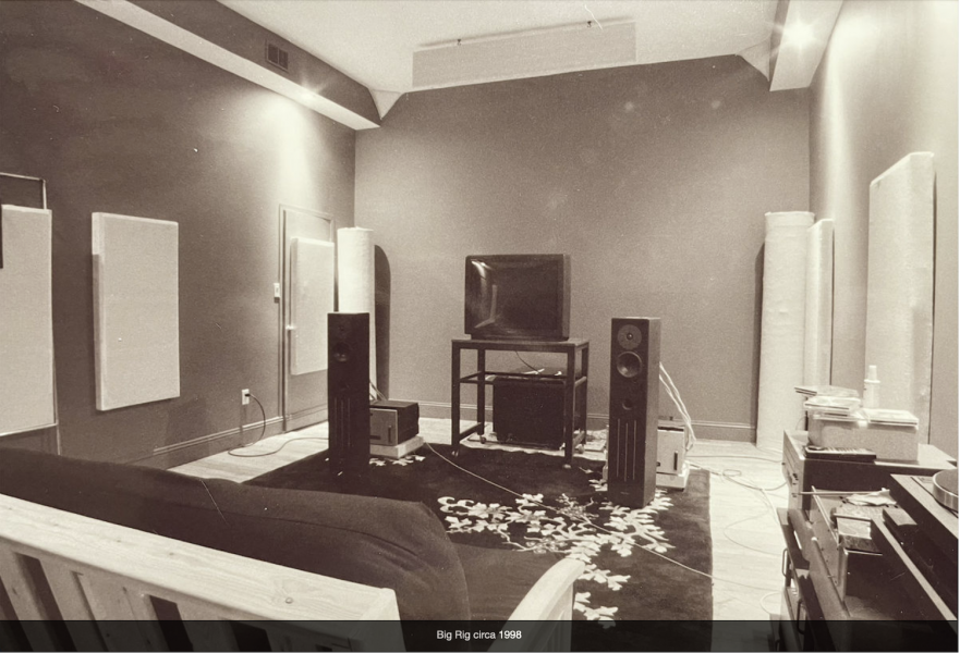

I've been in the same dedicated purpose-built room for the past 25 years. In the beginning it looked likes this. All the treatments were DIY back then and while they worked, they all had design shortcomings which I would either address in later revisions or purchase commercial replacements.

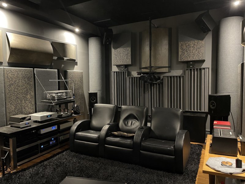

The pics below are of the most current evolution of my dual duty stereo & multi-channel music & cinema room. The move to a dual purpose system created many more loudspeaker sound sources, each with their early reflections to deal with. In these pics about half the visible treatments are DIY. The remainder were sourced from ASC, RPG, & Seven Audio.
Wow, I respect the work you all put in to your room. Congratulations. Nyal and his team have been great. He is very professional. I should not have stated "helped" solve bass issues. He actually solved the bass issues with humbling speed. I just 'fine tune'.

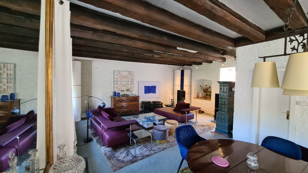

For sure, measurements are not the “ones who decide” but for me a really guidance.
What was measured: (Most of the measurement was done from each loudspeakers)
- The size of the room
- Reverberation time RT 60 from 9 different positions including listening position. 63 hz to 8000 hz. RT 60 went from 0,51 to 0,37
- Waterfall diagrams
- Spectograms
- Frequency from 22 hz to 49 hz (room mode)
. Frequency respons. (I have a “problem” with 26 and 41 hz. Axial room mode)
- Temporal course of the frequency dependent sound pressure level at the listening position
- Reflection behaviour at the listening position In ms detour in meter
On the attached poto you can see that left side is not identical to the right side. For example the tail oven on the right side. So always some small compromises to do.
In total I spent 3000 euro.

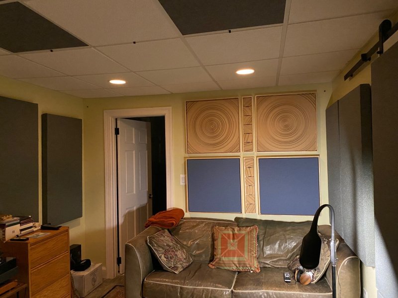

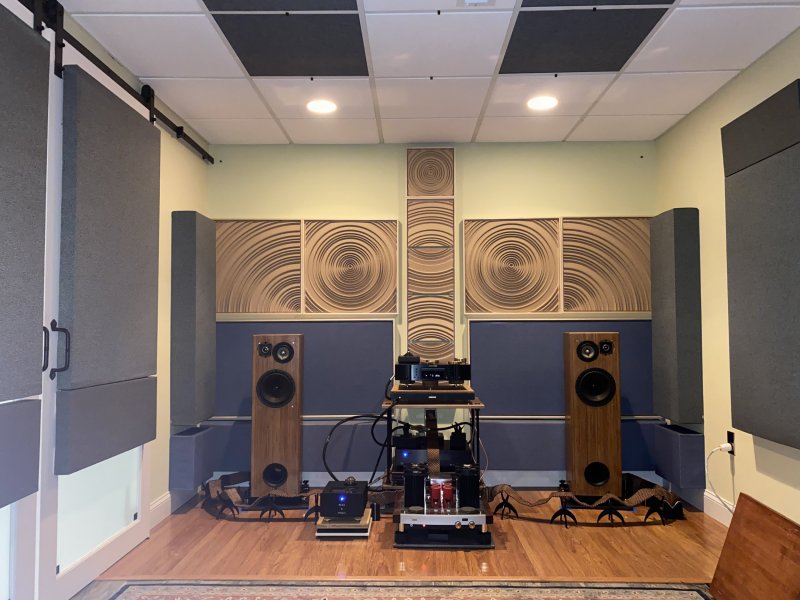

Hi all. Long time lurker. First time poster. My two cents...
I try to keep things pretty simple with room treatments. I put some basic 24"x48"x2" mineral wool absorbers at first reflection points. I don't even try to use bass traps to deal with room modes. Instead, I use multiple subs (two) and tweak their PEQs to get the best response I can. I had both a significant peak and a trough under my 80 Hz crossover point, but was able to eliminate both of those by dialing in some delay in my secondary sub. (I have two custom Funk Audio subs - a quad 18" and a dual 18".) After that I added a couple relatively small bell filters in the secondary sub's PEQ to flatten the low end response a bit more. That's about it as far as how I deal with room acoustics.
I use the Audyssey XT32 in my ancient Denon AVR. It doesn't work as well as some more modern room correction products, eg. Dirac, but it does well enough. I then do a few post-Audyssey setup tweaks like setting all speakers to "Small", crossovers to 80 Hz, and disabling Dynamic EQ & Dynamic Volume. I also increase the sub channel gain in my AVR by about 7 dB, and the Center Channel gain 1.5 dB.
My room's kinda ugly. Aesthetics aren't too important to me. I just want the room to disappear when the lights go down and the movie starts. Anyway, here are a few charts & pics -
I'm very pleased with the sound at this point, so I've transitioned from "tweak mode" to just enjoying things how they are...
Cheers!
~ Ward
Hi Ward!
Thank you very much for telling us about your room and your acoustics, and for the photos!
Those Funk subwoofers look great, and I an sure they work very well!
Reactions: henrich3
