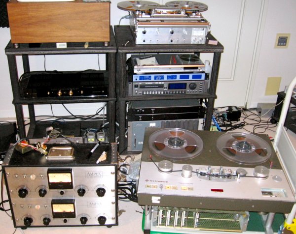

Telefunken
Good to hear about the great Telefunken decks. I've been after Ki to get a Tele M21. Here is a pic of my friend's M15 with Ampex heads and Ampex tube electronics. It is an imposing machine. The other deck on top is of his over the top Nagra Ti with tube electronics, based on the Ampex 351 circuit.
Rich Brown
