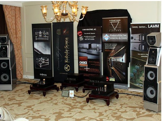

Yes, that's my understanding as well. The X-1 Grand SLAMM (2006) was rated at 95db sensitivity, 5 Ohm nominal.. Newer Wilson tend to be 91dB, 4 Ohm nominal down to a 1.5 Ohm dip. I have never heard a good explanation why they went in that direction beyond 'solid state'. I think they are missing an opportunity, but they remain successful.
At one time Vladimir owned the Wilson Maxx 3s (91dB) which he drove with M1.x, M2.x., ML2 and ML3. I saw him show with those at CES with the ML3. (He also showed with the Kharma Exquiste Classique. the Enigma Veyron and the Verity Lohengrin IIS -- whatever was big and expensive at the time.) Today there is a pair of bigger Wilsons (not MAXX 3) in the Miami showroom -- my photo is too dark to make out the model. Below was CES.
