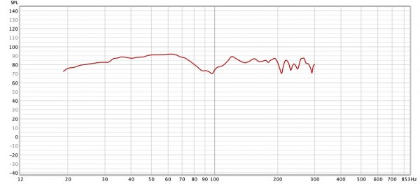

Due to the fact I have a small audio room, has meant I must listen in the nearfield. I have used this and also the cardas website for nearfield positioning - they mostly advocate a near front wall set up with loads of space behind.
I tried this approach and it resulted in a nasty dip at 97hz - its' the first image.

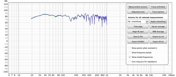

I then came across this article:
https://nsmt-loudspeakers.com/Nearfield-Placement
I tried to look up Leo Massi but sadly he is now deceased (i found out on an obituary page)
It advocates a mid room placement with ones head close to the wall.
I tried it and the results are superb - see the second image - yes a bit of a dip at 150hz.
I am minded to plug the ports (i have readings for that) but this was initial rudimentary tests andd I am pretty pleased so far.
I must say that I have ribbon tweeter speakers that are very smooth and high resolution (Roksan DArius S1's) the Ribbon really helps in minimising wall reflections - which I consider may well explain why Tensor speakers are becoming so popular in studios.
I now need to figure out what type of diffuser I need.
That's an interesting paper
I also have a small room and listen nearfield. The speakers tweeter is 4 & 3/4 ft from the front wall with the listening position 5 & 1/2 ft from the back wall in a 14 1/2 ft room. Distance to the tweeter is just over 6 ft with the tweeter 45 cm from the sidewall.
The balance changes as I move the listening position forward or back, a case of preference rather than right or wrong until against the back wall where bass becomes somewhat lumpy and less resolved. I ended up with this arrangement after much experimentation in the room, all tuned by ear rather than via measurement.
What I've never tried is anything as extreme as proposed here. I say extreme as I've never seen or heard of recommendation like this before.
From a listening perspective what do you hear? how does it affect imaging and tonal balance? Are you using traps in the corners as recommended?
Give the bungs a try, I needed them when I first set this room up. As I got to know the room and experimented with position I found I no longer needed them and the system sounds more natural without

Hi Defride - I'm glad you read the article.
The Classic Position
This was 'ALL ABOUT THE BASS' in the words of Maghan Trainor. There was an uneven juiciness in the lower octaves - quite entertaining in fairness - but with the nasty dip it was clumsy.
Imaging was good
Mid Room
I must say that the mid room position got rid of the reverb which gave that 'juicy' impression. It retains the depth but is far more fleet of foot. The depth of field is better too.
I've not started yet on diffusers nor first reflection points, likewise I haven't finalised width, but its improvement i would compare it to when rallying went from rear wheel to 4 wheel drive. I was absolutely shocked by the improvement.
I will say that Leo Massi advocates the use of even single driver speakers, or those that are phase coherent. My Darius S1 is a two way, but it must have been well designed. The ribbon tweeter helps in having very directional radiation (i hope that is the term).
I would love to try out some Fujitsu Eclipse with this set up once I have perfected my set up
