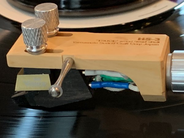

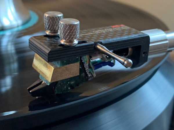

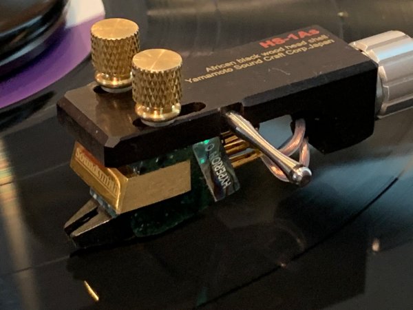

We have a stormy and rainy weekend in north/west Europe, which means time enough to play with new cartridges.
In my set up the Soundsmith Cartridges do prefer wood headshells and if a heavy headshell is the better choice in a particular tonearm, the Soundsmith screw set has the answer with >6gram screws .
As I do not have enough full wood headshells at home, (just ordered the original Soundsmith headshells)

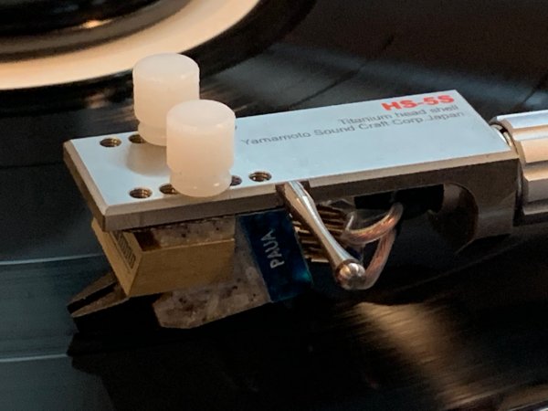

I had to try other materials as well. And the Screw set was again helpful. The Nylon screws added some kind of damping to the Yamamoto Titan headshell.
So finally, all 4 Soundsmith cartridges were fitted in an appropriate headshell, looking to the mechanical fitting only.

My Soundsmith "Paua" is fitted in an Ikeda 345 Steel Armwand version Tonearm with JPS Tonarmcable. The JPS cable is a more analytic cable with shiny highs. The old Ikeda Arm is more close to the old FR64s , than to the current Ikeda ally arm wand tonearms.
Peter Ledermann recommends on my "Paua" a value higher than 1kohm. A reviewer even recommended 2,8kohm as best.
For 2,8kohm I do not have the resistors available to solder this value, but 1k is a standard and works fine, but still a little too much shine in the highs for my personal taste (which is driven from preferring japanese carts like Koetsu und Air Tight over the northern style like Ortofon Windfeld Ti or Anna)
So I tried a little lower impedance, I had resistors for 860ohm available, which is just the little less, which makes the "Paua" sing in my set up (will be different in other set ups and with other personal taste)
I am sure, that the next level of fine-tuning VTF and VTA after more hours of boring in the carts might overrule this choice, which is a snap shot "best choice" for the current hours playing time.
The "Hyperion Signature" is fitted in a SME 3012R Tonearm with a Phasemation Tonearm cable, which is a neutral to warm sounding copper cable.
Peter Ledermann recommends 400ohm or more impedance match for the Hyperion. Looking to the available resistor values, I have chosen 500ohm, which makes the Hyperion playing a little, very little warmer the my current "Paua" set up.
It is very difficult for me to set up the Hyperion, even with 47kohm it plays like out of this world. And changing the impedance value is not only changing the tonal balance, also the energy the cart is sending the rest of the gear is changing. I tried the 860ohm I am using on "Paua" and to my surprise the Hyperion plays a kind of wrong, going back to 500 or 47k and ist better (but very different in character).
My current best choice is the 500ohm, as the Hyperion OCL Signature does play very natural.
And very very clear, without becoming analytic.
So you have all the information you can dream of, without changing the tonal balance in the way, that you have prominent highs to feel information.
As said for "Paua", I might change the value a little, after my final run on VAT and VTF, not forgetting the Azimuth.

Some pictures to illustrate the different Headshell, Headshell screw installations.

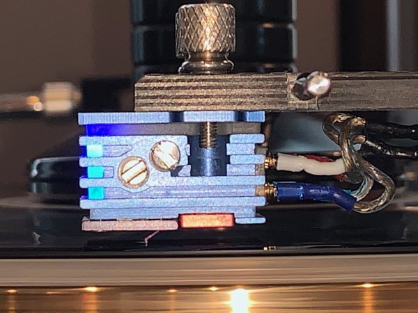

my personal comparison of SoundSmith cartridges goes to the next technical level,
as my first Strain Gauge Cart is arrived.
- Soundsmith SG 210 with SGS -6 OCL cantilever (and optional SGS-5 )
A Strain Gauge system needs an external 2x24v DC Power Supply, the Cartridge principle is based on the change of the resistance of a Strain Gauge in a way, that the resulting current change is nearly matching the reverse RIAA curve.
As with DS carts, a Strain Gauge based Cartridge needs a unique Phono Stage, which is supplied as standard from Soundsmith.
My Version includes a variable and a fixed output and is the SG 210 called.
The most Soundsmith carts do like more heavy tonearms , so I fitted the SG 210 in an Ikeda 407 (steel arm wand) tonearm, using a Yamamoto carbon Headshell.
But I will exchange the Headshell to a wooden Headshell soon (hopefully when the postman rings th next time)
My other Soundsmith carts do like the wooden headshells more than my Titan or Magnesium versions, so I assume, this will be similar for the SG 210.
I have chosen the SGS-6 cantilever to be more close to my Hyperion OCL, so the comparison of this two carts can happen with a similar cantilever (no cactus an SG carts)
The Hyperion is connected with my Boulder 2008, the SG cart with their matched SG210 phono stage .
Cables are both JPS Aluminata.( XLR and RCA versions)
The first impression sees the Hyperion OCL Signature / Boulder 2008 combination in front of the SG210, but the Hyperion has seen around 30h more than the SGS-6. And , more important, I already did some fine tuning in Hyperion.
I will do the tweaking on SG 210 after some hours of playing, at the moment VTA and Azimuth are just adjusted "parallel" and VTF is on the starting 2,3g.
Looking forward to proceed comparing. Such a rare chance to have both carts on one turntable :)
( Unfortunately I do have not the same tonearms available, so I will have an overlay of SME 3012R IMG_2570.jpg IMG_2572.jpg IMG_2573.jpg IMG_2574.jpg and Ikeda 407 comparison)

After having spent some more hours with the SG 210, doing some fine tuning on VTA, VTF and Azimuth I did some more comparisons.
The SG 210 is able to do something very unique in the midrange, very clear and smooth. Even with the SGS -6 OCL cantilever there is nothing sharp or hard.
Comparing the SG210 (recommended retail price incl VAT in Germany is 11.5k) with a Sussurro MkII (Retail in Germany 6K) and a Audio Flight Phonostage (Retail 5K) shows, that the Strain Gauge concept is far better in all matters.
I have some other Carts in the 4 to 6k range and also some other phono stages between 4k and 8k
(like Lampizator, RCM, LAB12 Phonostages), but the SG210 set does outperform them by ease.
But my current best combination, the Soundsmith Hyperion OCL Signature / Boulder 2008
( retail in Germany was 50k together) pairing again outperforms the SG 210.
The Boulder / Hyperion does show a much better and precise resolution in the lower end, where the SG210 is more limited in resolution and punch.The midrange does show a different interpretation of "clear and natural" , the higher end again has more substance and power with Hyperion and Boulder 2008.
In the next weeks, I will get 2 different 24v DC powersupplies for the SG210, as I believe, that a part of the bottleneck can be found there.
I also waiting for the shipment of more wooden headshells. The Carbon headshell, which I use with the SG 210 eats a lot of energy, may be too much for the SG 210 Cartridge body.
