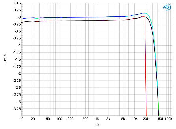

One method to resample to a higher rate but then filter gently since we don't need to be flat in ultrasonic frequencies. Here is an example in my quick search:
The graphs to the right are the 96 Khz ones, the one to the left are 44.1. With the latter, we are so close to the audio pass band that very sharp filters are used. Whereas with the 96 Khz, we can take 30 Khz to get down to nothing.
Adding on, if we deliver at higher PCM resolutions, then we don't need to resample either yet take advantage of gentle roll off which can be user selectable.
