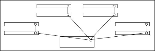

"If I was still allowed to post I would put up this note from the AP knowledge base.
"Recommended Test System Grounding"
which specifically shows that Amir is doing his testing incorrectly & neither he nor all the pseudo-EEs know enough to do this
Diagram of analyzer in center with grounds radiating out to the switchers.
"Audio Precision strongly recommends connecting the chassis ground of each device directly to the ground of the test instrument via wires having as low an impedance as possible. This technique is often referred to as “ground bonding” or “chassis bonding.”
Diagram of ground from analyzer to first switcher, and then daisy-chaining all the others.
"We do not recommend bus grounding (daisy chaining), where several devices are serially connected to a low-impedance conductor called a “ground bus.” The resistance in each leg of the chain puts the devices at different ground potentials, and is not as effective as star grounding."

You should include this too No sense not giving the whole story
Combination Star/Bus
Diagram of grounds radiating from analyzer to four switchers, and then a small jumper from each to another switcher.
When the serial links are very short, the combination star/bus grounding configuration can simplify connections while providing good grounding performance.
