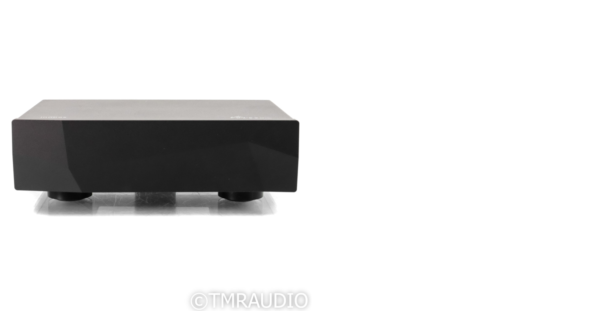

I have this. I put it before my audiophile switch. Then a Revelation Audio Labs Prophecy CryoSilver Reference CAT8+/RJ-45 ethernet cable to my Aurender.

Place it between the eero Pro 6E mesh router and the netgear switch, everything connected to the switch is isolated.
I think this is @Zuman 's set-up.
Most streamers are low noise, the better the streamer the lower the noise and they usually run off 15w. Servers draw a lot more power, Windows consumes a lot of power, even my little headless Mac Mini M2 consumes about 180w. He will likely benefit from moving the server so it is isolated from the DAC by fibre. As he is using the server as a transport as well, he will need a standalone streamer. The layout I suggest isolates the DAC from the router, switch and server.
