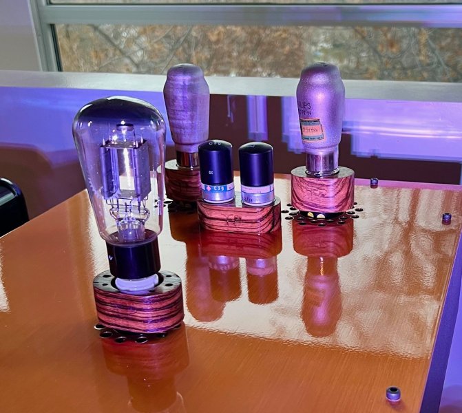

Obviously I’ve never heard the Poseidon, but this is my current configuration of the balanced Pacific2 w/ the Valvo G2504, 2x Telefunken C3G, 2x Siemens C3G, and 4x Philips PT14 tubes, and it is sublime. If my prior DACs were V8, this is V10 or V12 – not necessarily faster, but just more goodness.
I just cannot describe the last nth degree of vocal realism and timbre, but if this is what DHT is about, I’m sold.
In listening to Lukasz’s recent interview, I think DHT has a special place in his heart if not for how difficult it is to find tubes, and this isn’t just unique to Lampizator. Alas, in this bottomless pursuit, for me it’s worth it. If my house ever burned down and I lost all these tubes, I’d probably give up on audio.
So curious to have a fully tube-rolled Horizon vs Pacific 2 to just hear the stylistic differences.
What tubes do you have in this PAC 2?

The Valvo G2504 + TP's latest adapter absolutely smokes anything else I've ever heard. In the world of diminishing returns, the new king is a lightyear away from my other rectifiers. The delta in details, tonality, and gain in realism are on the level of changing 2-3 components, and this is only after 24 hours of burn-in. It's one of those moments in audio where I just can't ooze enough superlatives to express my shock. If I ever had to buy another Pacific, the first thing I'd do is to get TP adapters for its tubes.

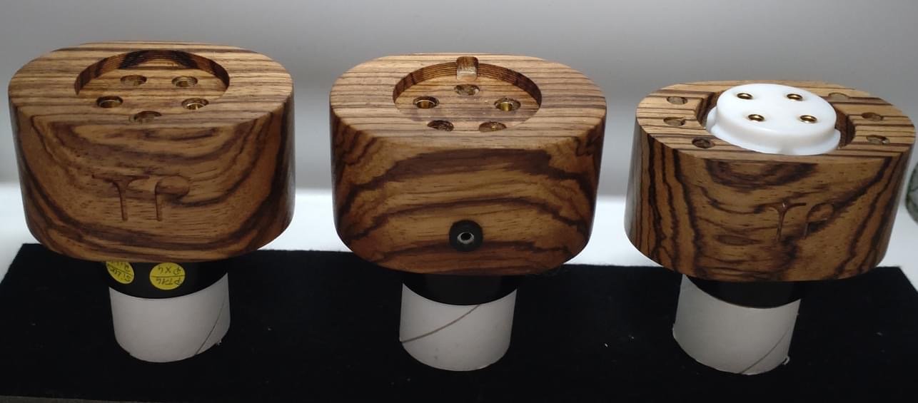

what type of adapters is needed and where you obtain it? I am new in Pacific. Thanks
Different valves need different adapters. Some also fit straight in without an adapter. Most people here use a shop on ebay called xulingmrs or also called Xuling Audio Labs, or if you want the best, contact @takacs75 on here and he will make you one

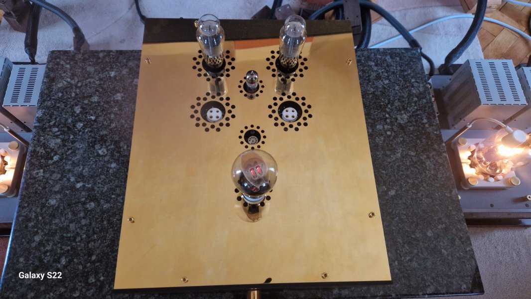

Have you also tried E83F instead of the C3g?
What is your recti in the above picture?
Thanks, Christoph. I have several different versions of the E83F and bought the TP adapter for them as well.
I was able to source some special lab sample 45 degree getter Tungsram E83F through Laszlo and those are my favorite E83F. Amperex PQ gold pins E83F are also very good.
Lab sample Tungsram E83F were my daily drivers and favorites (I preferred them to the Siemens C3G), until I got some Telefunken C3G (not the "S" version).
Rectifier is a 1943 german military Valvo G2504. Since I took that photo, I have now installed Laszlo's silver ribbon grounding wires for all tubes.

If I see it correctly, your rectifier is solid plate and not mesh.
Did you compare both versions and decided for the solid plate?
