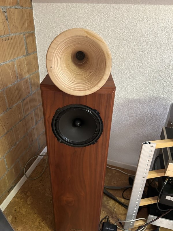

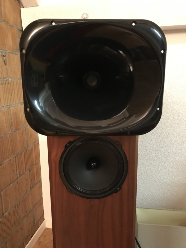

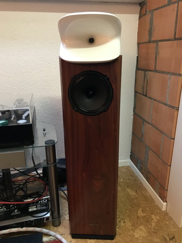

M morricab Well-Known Member Apr 25, 2014 11,081 6,426 1,958 Switzerland May 31, 2025 #21 ajant said: Are your speakers with Tractrix horns two-way? If so, which horn driver? Click to expand... Yes, I use a Beyma CP755Ti crossed at 800Hz or a Beyma CP350Ti in an Iwata 600 horn crossed at 1800hz. Midbass is a Supravox 215-2000 8 inch driver in a TQWT cabinet
