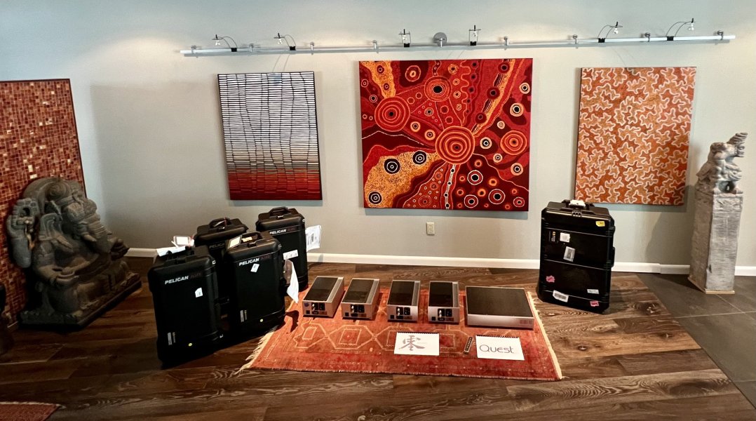

I am looking forward to this epic demo. Gary has been a prince to sort through the logistics of pulling this demo together.
The Quest arrived yesterday, ensconced in its Pelican travel shell. I unpacked and powered it up to ensure all is good. REIs are scheduled for Friday. I have made an offering to the shipping gods at FedEx for a good outcome.
The power feed you describe @seatrope looks like an excellent way to manage things. I have considered a sub-panel more local to the audio gear, which makes it easy and technically smooth to run a few dedicated lines.
As it is, I have two dedicated lines: a 12ga and a 10ga running the show. I may not get a new line run before the weekend, so I am wondering if OK for demo to run four REIs off a 12ga line with two Shunyata duplex outlets.
In no way do I think that's optimum, but I may not be able to reasonably expand in the next few days. We'll see.
