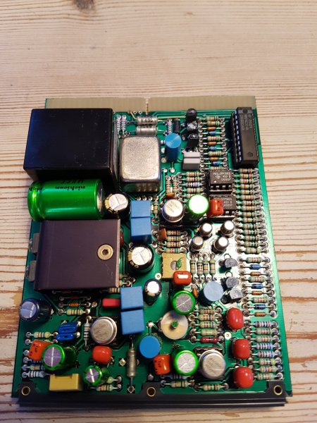

have you done anything to the stock line and repro boards on the A810?
my A810 is heavily modified in the signal path acc to instructions from Todor Dimitrov of MTSL
pretty close to an all out A80, but not quite there
changed all 5532 to 49720H metal cans...including the one in the headblock pre......did a lot to resolution
I haven’t. My A810 is pretty much stock although it had been completely recapped.
recapping and checking bearings are first priority
you changed ALL electrolytics in the machine?MB, main psu and motor caps, RIFA X2 s etc?
I´ve done MTSL mods on two A810 and a friend on the 3rd.
only missing on mine now is rewiring with kapton/silver wire, which improves on resolution as well
I didn't do the work myself so I don't have all the specifics.
Where are all the 5532s and do you have a picture of a board with the 49720Hs installed?

Thanks for the pictures.
I have some of the repro board too...thats the most modified, bypassing functions and ripping out components...
detailed inxs and parts are to be bought from MTSL, apart from the opamps
