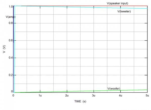

Figure 2 shows the response into the speaker using a single 8-ohm wire. The amplifier’s output and speaker’s input are essentially the same (with the expected time delay, barely visible at this scale). Recall, or realize, that an inductor will reject high frequencies while a capacitor rejects low frequencies. The inductor looks like an open to a high-frequency signal, and the capacitor looks like a short. With the step input signal used, the tweeter responds immediately, then falling as the capacitor charges since as the pulse stays high it looks more and more like a d.c. signal. The inductor blocks the high-frequency step from the woofer and thus its voltage rises only very gradually.
Figure 2: Single 8-ohm speaker wire.​
