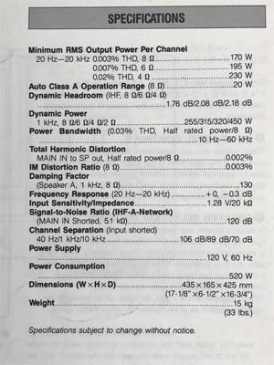

Hello all. I’m looking for a new turntable for my vintage stereo system. I have been doing some research and note that many of the audiophiles who respond to such threads want to know what the current system specs are of the OP. So, this maybe a long thread but hope to get it right the 1st time. I believe the components of interest would be the following. CONTROL/ PRE AMP: Yamaha C-85, 1988 $765 ; POWER AMP: Yamaha M-65, 1988 $720 ; REAL TIME SPECTRUM ANALYZER/EQUALIZER: AudioControl C-101, 1988 $430 ; LOUD SPEAKERS: JBL Control Monitors Model 4312, 1990 2@ $840. These components have had the best of care & although I couldn’t guess the hours on them they have never really been cranked up volume wise due to living arrangements. Since my TT had been stolen in ’87 they have probably had a 100 hours of use. See attachments for specs.
