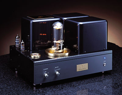

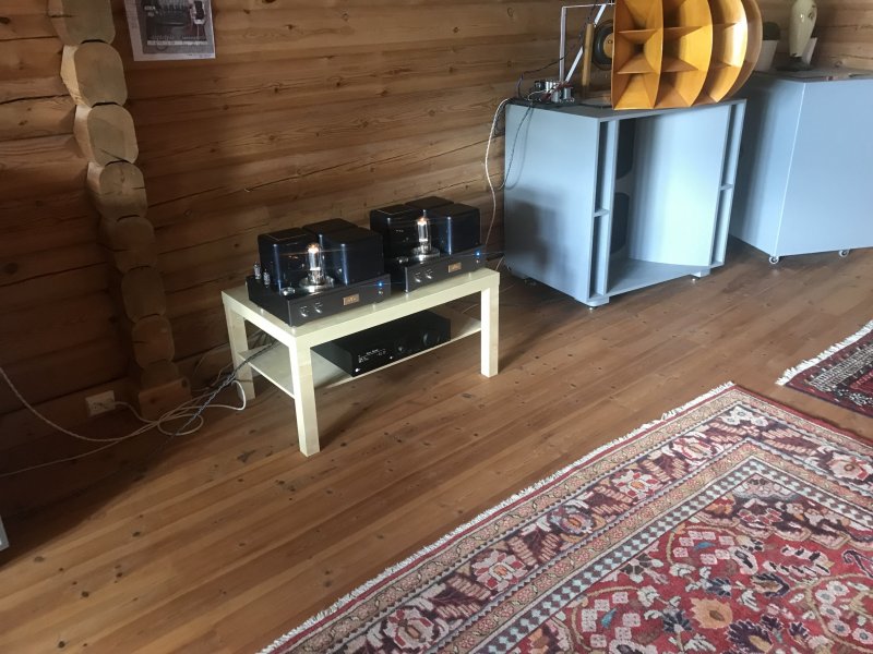

First impressions are WOW! Om my VOTT the SQ is just on another level compared to the SS amps. The room is huge and the separation of the instruments/voices is simply fantastic. The only issues is the transformer hum that is clearly auditable as the 817 are extremely sensitive… but I guess that’s the nature of zero FB design!?

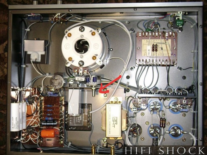

The airtight 211 hum is mentioned here
Apart from the hum both amps are totally noice free, no hiss from the 288/1505 or UHT. The level of hum is not affected by the attenuator (gain/volume adjust) on the ATM-211
Yes! I was aware of this issue. And frankly I don’t really care as the SQ more than compensate for this minor issue.
Reactions: bonzo75
Yup …A good Ol In circuit ‘Hum Bucker’ altho there are several very good ‘plug In’ products on the market these days
Balancing the heating voltage does not always help with direct heating tubes. but usually the hum afterwards so low that is tolerable.
