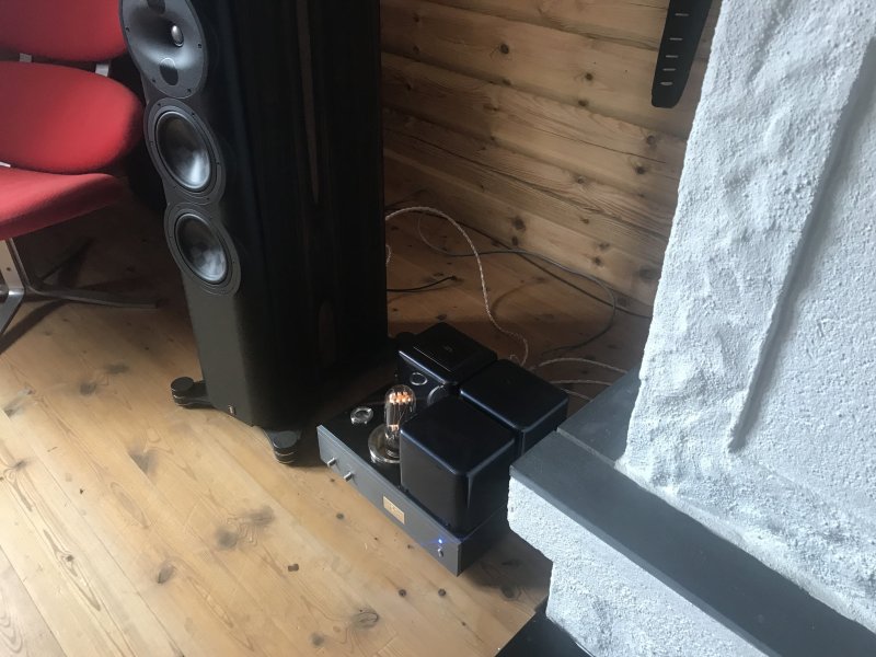

Ok! But if you don’t see any more posts from me here it didn’t work for me…IMG_7472.jpeg
Problem sort of solved… I connected til ATM 211 to my Perlisten S7t(92-93 db sensitive) and you have to be within 1 m.(3ft) for the hum to be of any issue.
