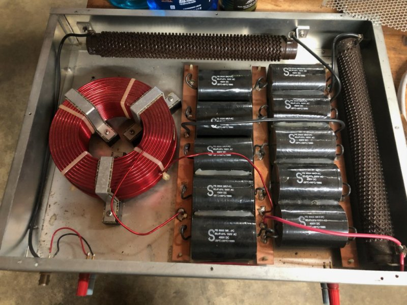

I would be interested to know what kind of 8 ohm load that was (8 ohm load resistor or a speaker dummy load with capacitors & coils and resistors). If it was the former, even a poorly designed amplifier can do it. The real problem with set amps is that they amplify to different levels without negative feedback and follow the impedance curve and phase response of the speaker. The poor negative feedback reduces this problem, now it's about finding the right level without it damaging the sound. If you don't want feedback, then you build an RCL element into the speaker that smooths out the impedance curve if the manufacturer hasn't already done that. The disadvantage of this solution is that you lose speaker efficiency. Then you'll hear your set amp amplifying evenly, just as the designer intended.
Reactions: Atmasphere
Exsample real world impedancedummy load of a speakerView attachment 138627
