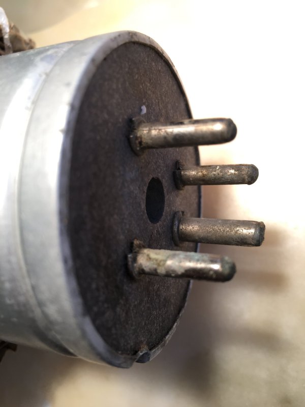

Since we're pre-Christmas cleaning, what do you guys use to clean corroded (historical) power tube pins, especially also ones that are hollow inside so no liquid should seep in? Thanks in advance!

Can you show a picture of the corroded pins? :oops:

The fiberglass pencil is an excellent suggestion
Part of my method here. For connectors I dismantle everything 2x per year and polish with the cloth suggested, wipe with the appropriate deoxit- usually D5 and then wipe clean with 99% IPA. I don't use anything but 99% IPA in tube sockets as tracking from various chemicals can cause horrific problems in sockets

I have tubes with pins that started out like that. Your never going to get them bright finished. There is deep pitting. I too have used an abrasive paper. I prefer to not use something so aggressive. I would only use it to round the tips that appear to have sharp edges. Nothing less than 2000 grit. Brass wool works too. Don't use steel wool as any material that imbeds in the pitting will rust and cause its own issues.
The fiberglass pen looks interesting. I bet a small piece of fiberglass insulation used like a scrubbing pad would also work.
I use Deoxit but I don't remove it with alcohol.
Deoxit by Caig is supposed to be non conductive. Yea, sound odd for something you put on electrical contacts. I have used it on probably 50 or more tubes and never experiences arcing. Evan tubes hitting 1000 volts. I do apply it, then wipe it off well.
