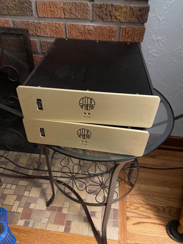

I'm a recipient of one of those semi-production pairs, which has since been forwarded to the next person (who told me that he is buying the pair). In my opinion this new Class D amp sounds like Ralph's OTL amps. The difference is, the way it interacts with a loudspeaker's impedance curve is characteristic of a solid state amp, not an OTL amp (or other high-output-impedance amp like an SET). This of course opens up a much wider range of speaker options.
Let me try to put into perspective how much I like Ralph's amps:
Every single one of my loudspeaker designs (going back to my first commercial product in 2005) has compatibility with his smaller OTL amps, the S-30 and/or M-60, as a primary requirement. At audio shows, I have shown with Ralph's amps more than all others combined. I never imagined there would be an amplifier which combined easy speaker compatibility with OTL-class sound quality, much less in such an otherwise user-friendly format. The only downside is that my speakers will no longer be "especially compatible with Atma-Sphere amps", so my marketing department will have to come up with a new pitch.
I will be purchasing a pair of the full-production version when they become available, because I want to be able to ship a fully representative demo pair to the skeptical-but-curious.

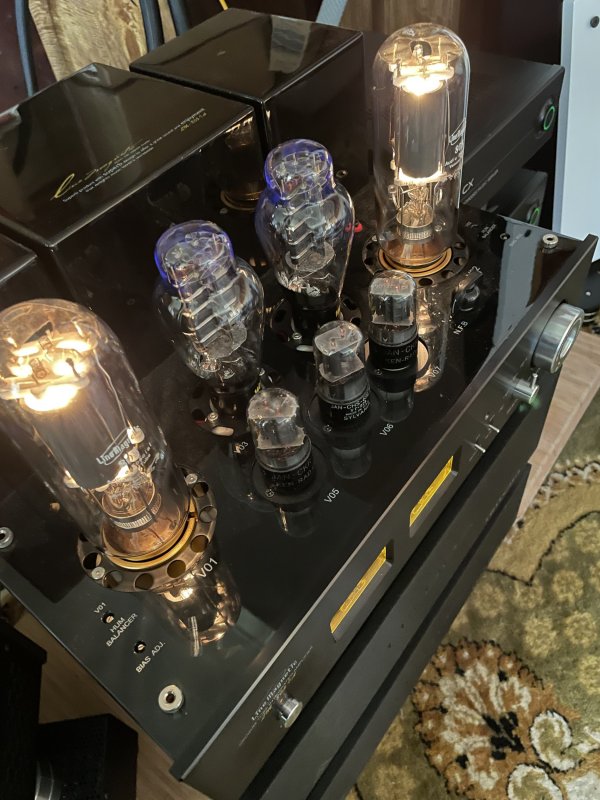

Very happy with this move. The WE300Bs really have brought in a big chunk of magic. I was toying for going with another amp for the main system but I doubt that it would have bought the kind of step up that went with these WE300Bs.
$1500 usd a pair is a good chunk of cash but nothing in the scheme of the high end and what this upgrade has brought with it. I’ve heard plenty of top end amps and what I’m now getting out of this current setup may not necessarily be universally better than all but very definitely is competitive and more on point for what I really love. This WE300B balance fits beautifully with all upocc silver signal cables and brings with them a lovely fleshy balance, full lively dynamics and a real sense of effortless musical ease and flow.
The Linlai moly 805s will likely be the next change up for this amp. Each step is just moving closer again to where I would like to get it. Based on what I am hearing I’ll likely get in a few pair of the WE300Bs this year. One pair as back-up for this system and the other to run in the LM Set for the Harbeth 40.2s. The new WE is way good :)

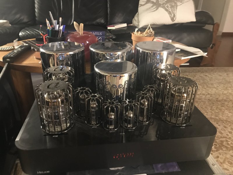

The second Is an Ayon Helios, which is a 40 watt PSE using the 6c33c triode driven by a pair of EL84s and a 12AU7 input stage.

The first is the Amare Musica Entropy Diamond, which is only 2 tubes per channel. Both are DHT both from EML. The input driver tube has about 20db if gain but can also serve as a 5 watt output tube. The actual output tube is an EML 1605, good for 23 watts.
Those Amare amps ( De Forest Pre and Diamond monoblocks) were the best I auditioned at home with my former AG Duo Omega.
