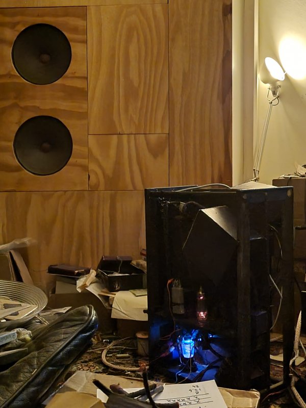

This is a G2 mode EL519 my best friend is building for me, El519 in G2 triode is the original idea of Cees B where I heard this circuit for the first time a few years ago and after hearing some other mesh tubes it 'stuck'. Here it is used in a one tube design using an input transformer, a mercury rectifier and an enormous choke. The low part count makes selection of components and placement quite critica so we feast our ears using rare and mostly handmade components.
No output transformer?

My "Trionor' , which is an adaptation of the good old Bionor. Now using three 13"Tesla Full Range drivers. The speaker in the picture is a Klangfilm open baffle with two KL405's at my friends place.
