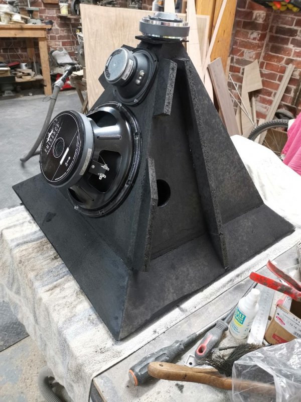

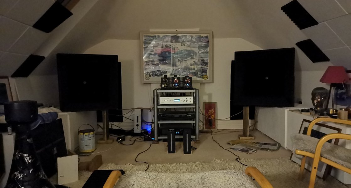

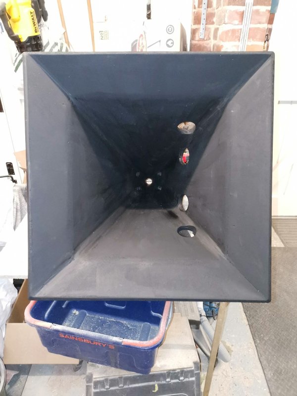

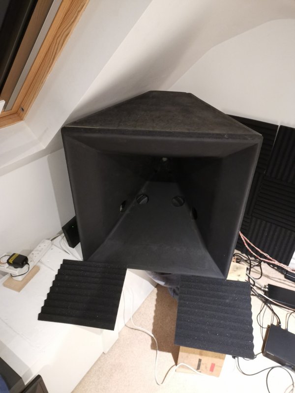

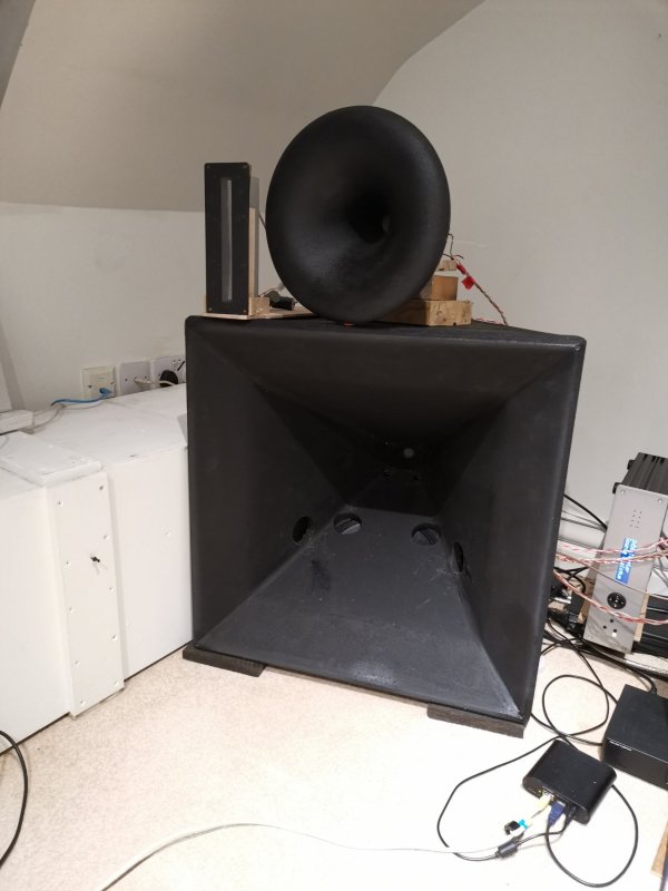

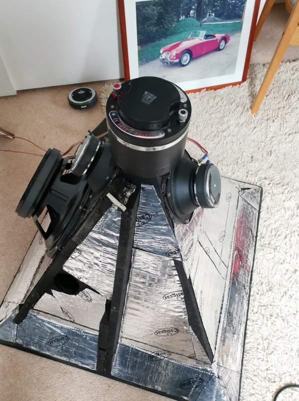

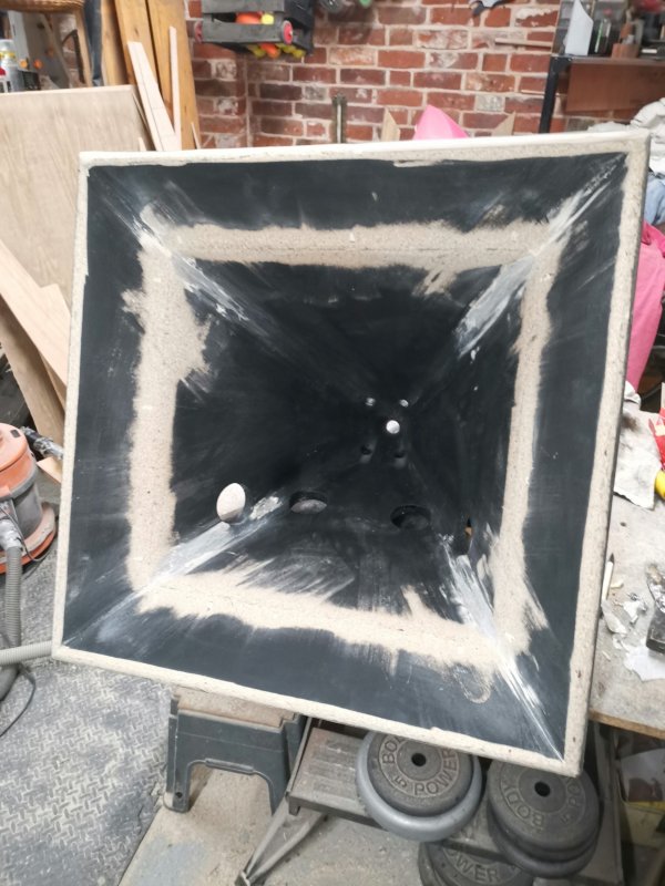

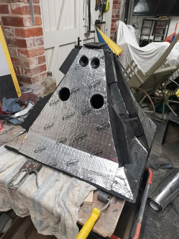

Quick update in pictures.

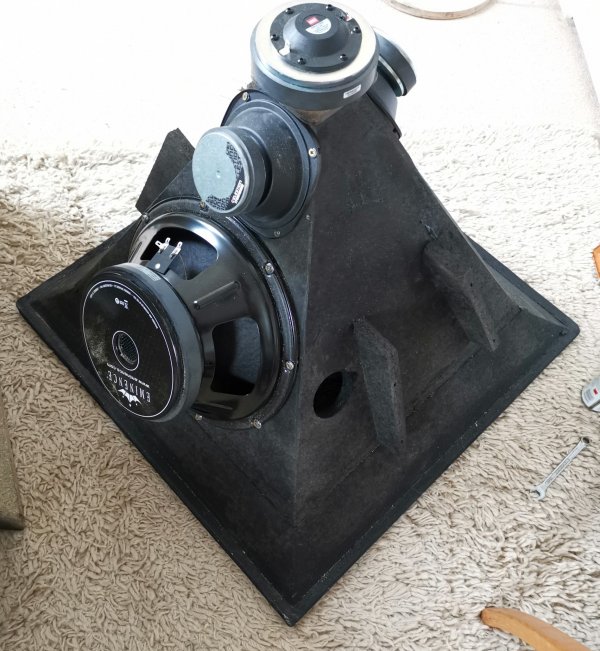

I built a pair of SH60 profile Multi Entry Horns.
Same drivers.
They start smallish :)
Flares on. Trying something other than black
Several visitors and wife liked the terracotta one. So...
One SH50 style Vs one SH60 style
Then the pair

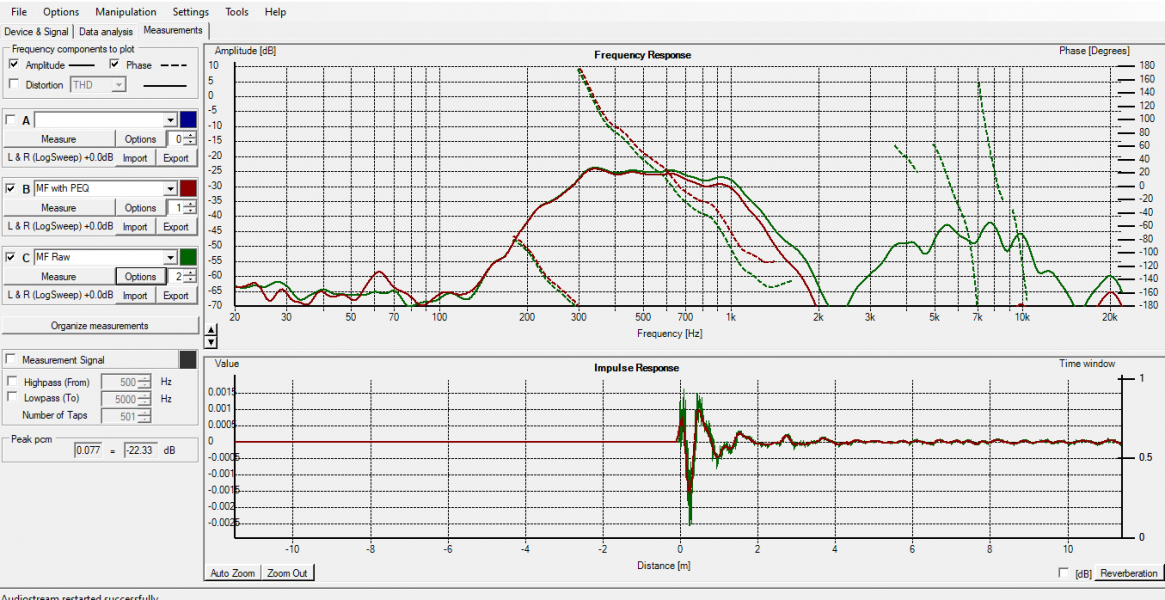

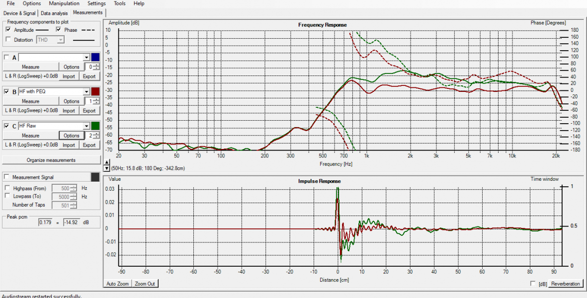

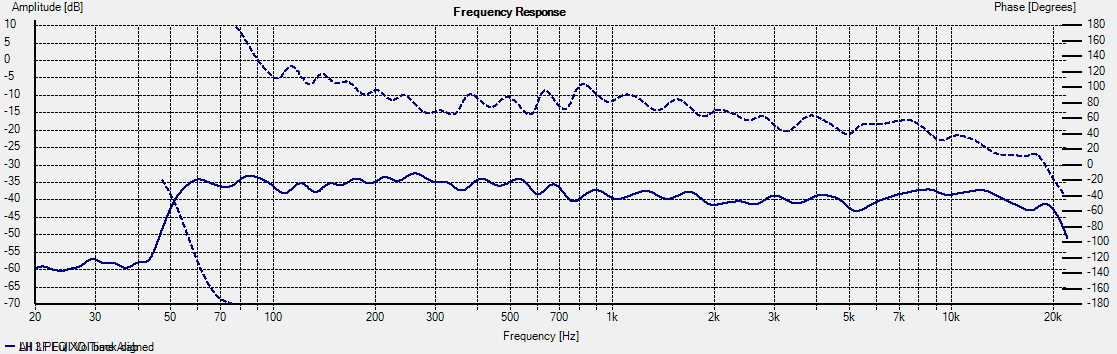

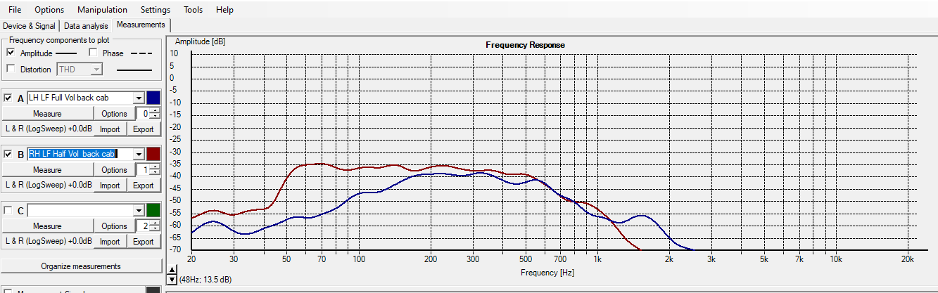

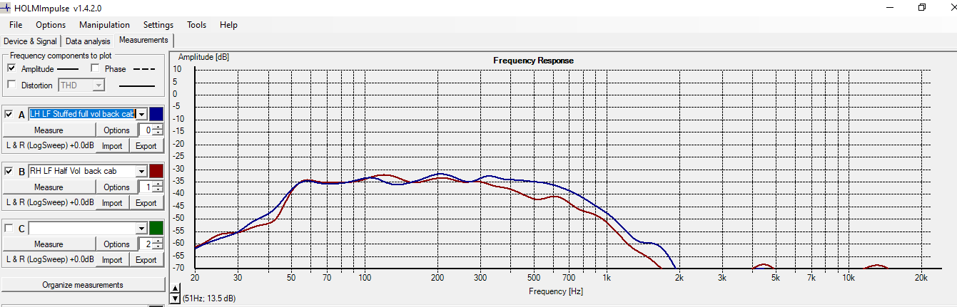

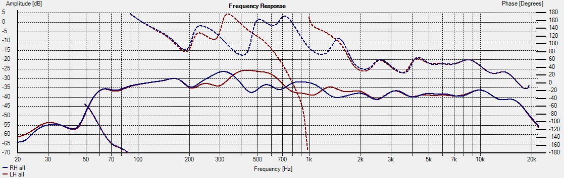

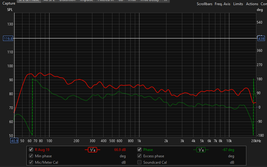

Some measurements at 1m.
Ignore the dB level. It's due to gain setting on the phantom mic pre. Not the actual level at which I took the measurements
Look how the phase snaps together when the drivers are sewn together in time..

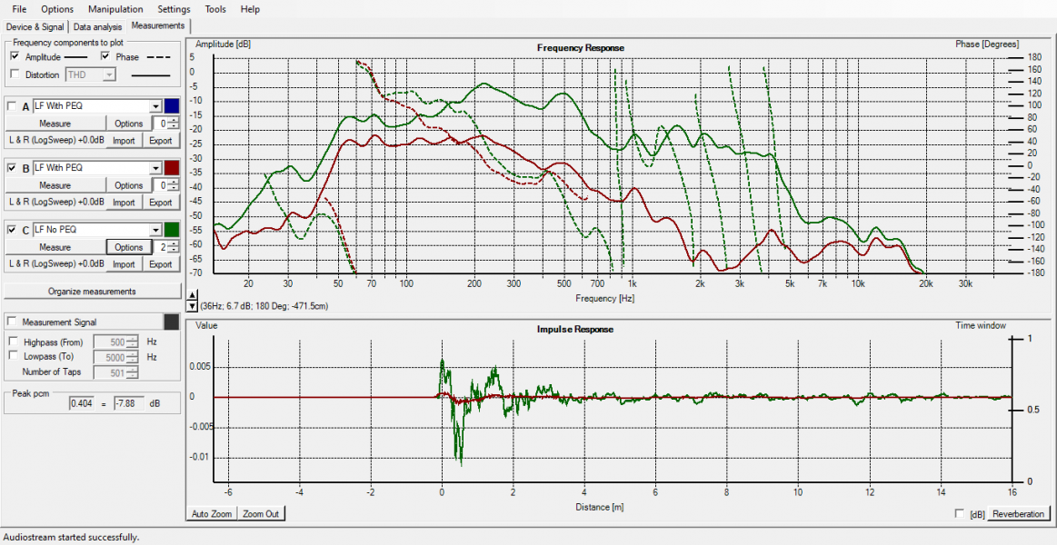

And the LF completes the trio.
The phase plot is excellent!
Who was it who quoted "A changing phase is changing time"?
The main take away from the 60s Vs the 50s in listening evaluation is that there is more definition or tonal rightness, emotion even, in the HF frequencies.
Wasn't expecting that!
Still have all the single point, drivers perfectly in sync and phase tightness sound MEH thing going on!
The other thing, and perhaps it explains the above, is that the centrally mixed image (usually vocal) is rock steady in the middle.
There's still all the detail and dynamics out wide when the music contains that, it's just that the central imaging is now excellent.
That would have been my been my only real criticism of the SH50s in my particular room.
The SH60s are a setup I feel I can grow old with
