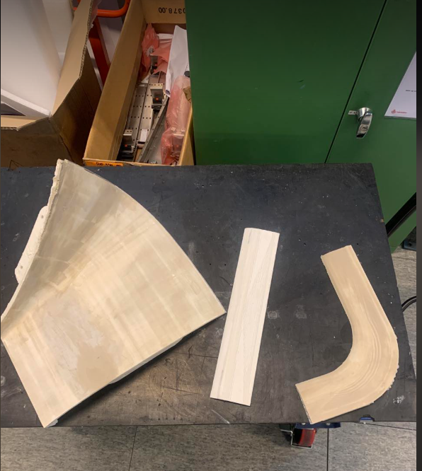

Lot's of different hifi projects going on in my end. Being quite fond of my ribbon horns, I designed a bigger and hopefully better horn in CAD. Being 70x55x30 cm I had to chop it up in my CAD program, making it eatable for my 3d printer to print.
Printing multiple pieces without to many failures, is one thing, putting it together and then make a nice finish, is another. It cost a lot of time and elbow grease, even when not striving for perfection.
Somehow the flange around the mouth has gone way to short, so some improvisations was needed. Probably due to shrinking.
My first try to smooth the layer lines (I print with 0.8 nozzle or it would take forever) was with SLA resin. Some messy stuff and not very healthy. Paint it on in a thin layer, then UV light, sanding. Luckily I found a better and non toxic alternative, fine wood filler. It does the job and then finish with some filler spray (also toxic:rolleyes:)

Looking good, what driver do you plan to use and what size is the horn?
It's about 126 cm wide and 70 cm in height. Using the best ribbon driver I know of ;)
Will be interesting to compare to our horn with compression driver. Vertical directivity isn't going to be constant.
